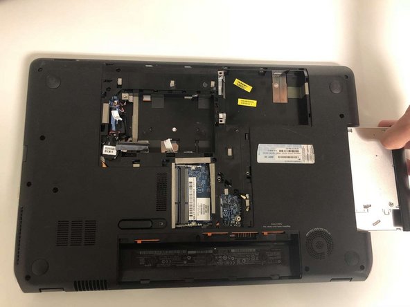

  6. HP Pavilion dv7t-7000 Heat Sink Replacement, CD Drive: crwdns2935265:06crwdnd2935265:01crwdnd2935265:02crwdne2935265:0 HP Pavilion dv7t-7000 Heat Sink Replacement, CD Drive: crwdns2935265:06crwdnd2935265:02crwdnd2935265:02crwdne2935265:0
    • Remove the single Phillips #00 screw.
  7. HP Pavilion dv7t-7000 Heat Sink Replacement: crwdns2935265:07crwdnd2935265:01crwdnd2935265:02crwdne2935265:0 HP Pavilion dv7t-7000 Heat Sink Replacement: crwdns2935265:07crwdnd2935265:02crwdnd2935265:02crwdne2935265:0
    • Pull CD drive out to remove.

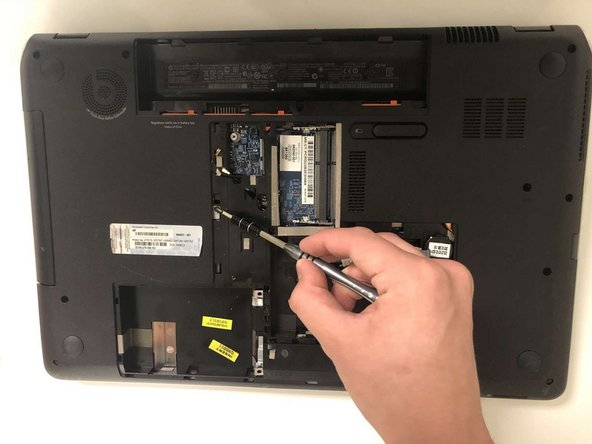

  16. HP Pavilion dv7t-7000 Heat Sink Replacement: crwdns2935265:016crwdnd2935265:01crwdnd2935265:03crwdne2935265:0 HP Pavilion dv7t-7000 Heat Sink Replacement: crwdns2935265:016crwdnd2935265:02crwdnd2935265:03crwdne2935265:0 HP Pavilion dv7t-7000 Heat Sink Replacement: crwdns2935265:016crwdnd2935265:03crwdnd2935265:03crwdne2935265:0
    • Remove single Phillips #00 screw.
    • Pull the card out by hand.

  20. HP Pavilion dv7t-7000 Heat Sink Replacement, Palm Rest: crwdns2935265:020crwdnd2935265:01crwdnd2935265:03crwdne2935265:0 HP Pavilion dv7t-7000 Heat Sink Replacement, Palm Rest: crwdns2935265:020crwdnd2935265:02crwdnd2935265:03crwdne2935265:0 HP Pavilion dv7t-7000 Heat Sink Replacement, Palm Rest: crwdns2935265:020crwdnd2935265:03crwdnd2935265:03crwdne2935265:0
    • Flip the keyboard back over.
    • Remove the single Phillips #00 screw holding in the CD drive.
    • Pull out the CD drive.

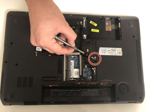

  21. HP Pavilion dv7t-7000 Heat Sink Replacement: crwdns2935265:021crwdnd2935265:01crwdnd2935265:01crwdne2935265:0
    • Remove the seventeen Phillips #00 screws securing the back panel to the laptop.

  24. HP Pavilion dv7t-7000 Heat Sink Replacement, Motherboard: crwdns2935265:024crwdnd2935265:01crwdnd2935265:01crwdne2935265:0
    • Remove the eleven Phillips #00 screws.
  25. HP Pavilion dv7t-7000 Heat Sink Replacement: crwdns2935265:025crwdnd2935265:01crwdnd2935265:03crwdne2935265:0 HP Pavilion dv7t-7000 Heat Sink Replacement: crwdns2935265:025crwdnd2935265:02crwdnd2935265:03crwdne2935265:0 HP Pavilion dv7t-7000 Heat Sink Replacement: crwdns2935265:025crwdnd2935265:03crwdnd2935265:03crwdne2935265:0
    • Use the flat end of a spudger to disconnect all wires connected to the motherboard.
