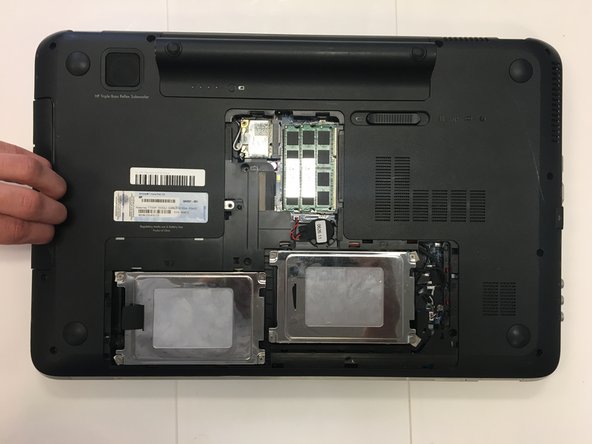

    • Turn the device over so that the bottom is facing up.
  2. HP Pavilion dv7-6163us  Touchpad Replacement: crwdns2935265:02crwdnd2935265:01crwdnd2935265:01crwdne2935265:0
    • Place your finger on the battery release latch and slide it to the right to release the battery.
    • The battery will pop up after sliding the latch.
  3. HP Pavilion dv7-6163us  Touchpad Replacement: crwdns2935265:03crwdnd2935265:01crwdnd2935265:01crwdne2935265:0
    • Firmly grasp the battery and remove it from the device.
  4. HP Pavilion dv7-6163us  Touchpad Replacement, Touchpad: crwdns2935265:04crwdnd2935265:01crwdnd2935265:02crwdne2935265:0 HP Pavilion dv7-6163us  Touchpad Replacement, Touchpad: crwdns2935265:04crwdnd2935265:02crwdnd2935265:02crwdne2935265:0
    • Remove service door by prying the plastic opening tool or the spudger under the door.
    • Lift door and set aside.

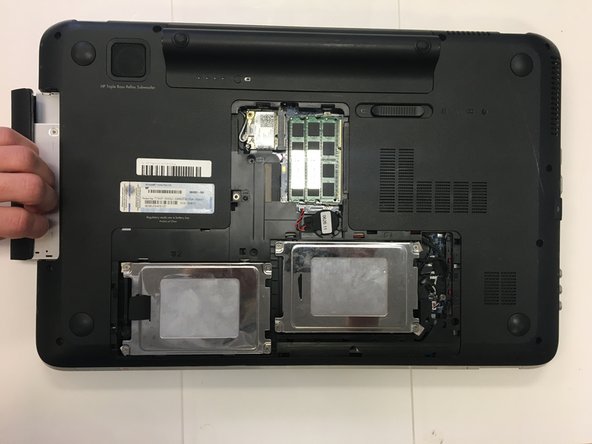

    • Remove the single screw securing the optical drive in place.
    • Detach the optical drive by sliding your fingers between the drive and the body of the laptop.
    • Pull out the optical drive.

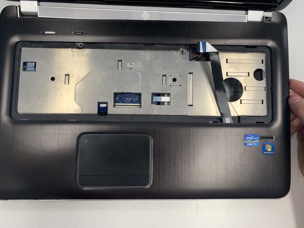

    • Turn the laptop right side up and open the screen.
    • Use the plastic opening tool to loosen and remove the keyboard. Begin in the middle top of the keyboard and work around the edges.
    • The keyboard will snap out, but do not remove it completely. It is still attached to the device by a ribbon cable.
  8. HP Pavilion dv7-6163us  Touchpad Replacement: crwdns2935265:08crwdnd2935265:01crwdnd2935265:02crwdne2935265:0 HP Pavilion dv7-6163us  Touchpad Replacement: crwdns2935265:08crwdnd2935265:02crwdnd2935265:02crwdne2935265:0
    • Flip up the keyboard to access the ribbon cable underneath.
    • Disconnect the keyboard ribbon cable from the motherboard.
    • Remove the keyboard.

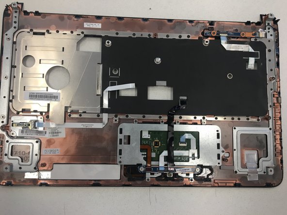

    • Release the faceplate with your fingers or a spudger. Begin at the top left corner and work your way around to snap the faceplate away from the body of the laptop.
    • Turn over the face plate to access the underside of the touchpad.

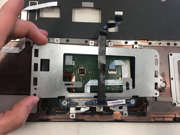

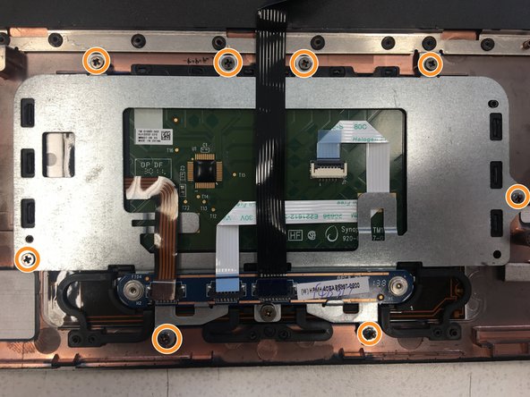

  10. HP Pavilion dv7-6163us  Touchpad Replacement: crwdns2935265:010crwdnd2935265:01crwdnd2935265:03crwdne2935265:0 HP Pavilion dv7-6163us  Touchpad Replacement: crwdns2935265:010crwdnd2935265:02crwdnd2935265:03crwdne2935265:0 HP Pavilion dv7-6163us  Touchpad Replacement: crwdns2935265:010crwdnd2935265:03crwdnd2935265:03crwdne2935265:0
    • Disconnect three ribbon cables.
    • Remove the eight screws securing the touchpad plate.
    • Remove the touchpad plate.
  11. HP Pavilion dv7-6163us  Touchpad Replacement: crwdns2935265:011crwdnd2935265:01crwdnd2935265:03crwdne2935265:0 HP Pavilion dv7-6163us  Touchpad Replacement: crwdns2935265:011crwdnd2935265:02crwdnd2935265:03crwdne2935265:0 HP Pavilion dv7-6163us  Touchpad Replacement: crwdns2935265:011crwdnd2935265:03crwdnd2935265:03crwdne2935265:0
    • Pop out the touchpad using a plastic opening tool. The edges should snap out of place.
    • Remove the touchpad.
