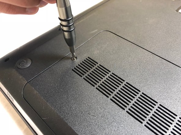

  3. HP Pavilion dv7-4285dx Keyboard  Replacement, Keyboard: crwdns2935265:03crwdnd2935265:01crwdnd2935265:03crwdne2935265:0 HP Pavilion dv7-4285dx Keyboard  Replacement, Keyboard: crwdns2935265:03crwdnd2935265:02crwdnd2935265:03crwdne2935265:0 HP Pavilion dv7-4285dx Keyboard  Replacement, Keyboard: crwdns2935265:03crwdnd2935265:03crwdnd2935265:03crwdne2935265:0
    • Unscrew the 5 black plate screws using a Ph#0 screwdriver.
    • During the removal process, the back plate will retain the 5 back plate screws.
    • Use a metal spudger to carefully remove back plate.
  4. HP Pavilion dv7-4285dx Keyboard  Replacement: crwdns2935265:04crwdnd2935265:01crwdnd2935265:01crwdne2935265:0
    • Unscrew the 7.2mm screws using a Ph#0 screwdriver.

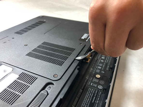

  5. HP Pavilion dv7-4285dx Keyboard  Replacement: crwdns2935265:05crwdnd2935265:01crwdnd2935265:02crwdne2935265:0 HP Pavilion dv7-4285dx Keyboard  Replacement: crwdns2935265:05crwdnd2935265:02crwdnd2935265:02crwdne2935265:0
    • Push the keyboard release switch using the metal spudger.
  6. HP Pavilion dv7-4285dx Keyboard  Replacement: crwdns2935265:06crwdnd2935265:01crwdnd2935265:02crwdne2935265:0 HP Pavilion dv7-4285dx Keyboard  Replacement: crwdns2935265:06crwdnd2935265:02crwdnd2935265:02crwdne2935265:0
