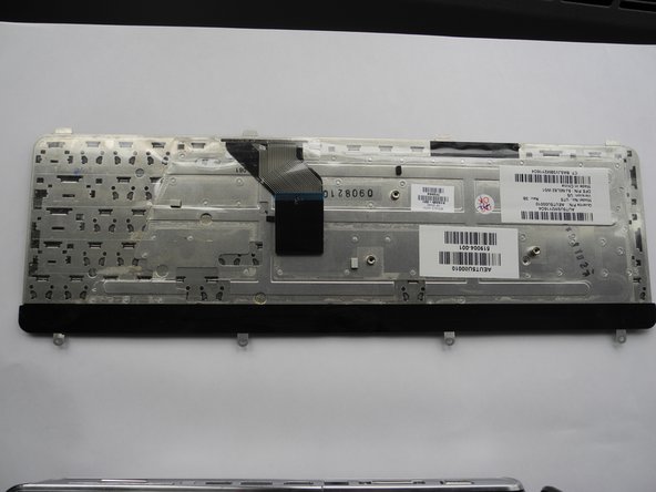

    • Locate and remove the screws that hold the keyboard to the computer.
    • Lift the keyboard up to expose the keyboard connector.
    • The keyboard connector is the small cord located near the screen of the computer.
  10. HP Pavilion dv7-3065dx Keyboard Replacement: crwdns2935265:014crwdnd2935265:01crwdnd2935265:02crwdne2935265:0 HP Pavilion dv7-3065dx Keyboard Replacement: crwdns2935265:014crwdnd2935265:02crwdnd2935265:02crwdne2935265:0
    • Disconnect the keyboard connector by unhinging the blue plastic clips and gently pulling the cord.
    • The keyboard can now be removed from the computer.
