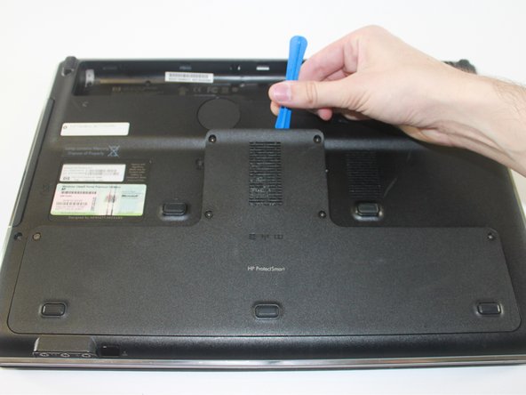

  4. HP Pavilion dv7-1448dx RAM Replacement, RAM: crwdns2935265:04crwdnd2935265:01crwdnd2935265:03crwdne2935265:0 HP Pavilion dv7-1448dx RAM Replacement, RAM: crwdns2935265:04crwdnd2935265:02crwdnd2935265:03crwdne2935265:0 HP Pavilion dv7-1448dx RAM Replacement, RAM: crwdns2935265:04crwdnd2935265:03crwdnd2935265:03crwdne2935265:0
    • Remove the six Phillips PM2.5X6.0 screws with a Phillips #00 screwdriver.
    • Pry the back casing up and away from the rest of the laptop with the plastic opening tool.
