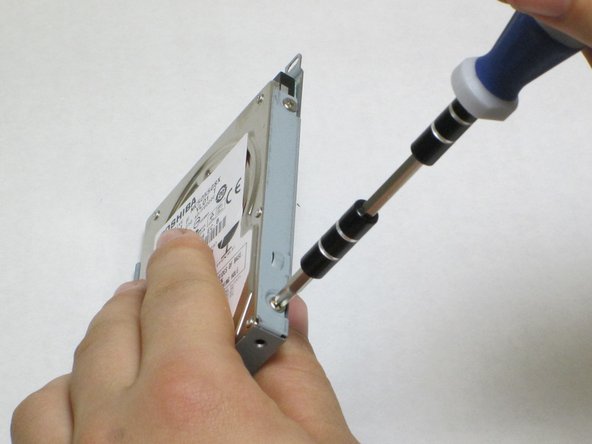

  6. HP Pavilion dv7-1285dx Hard Drive Replacement: crwdns2935265:06crwdnd2935265:01crwdnd2935265:02crwdne2935265:0 HP Pavilion dv7-1285dx Hard Drive Replacement: crwdns2935265:06crwdnd2935265:02crwdnd2935265:02crwdne2935265:0
    • Remove the 4 Phillips head screws located on the sides of the hard drive (two per side).
  7. HP Pavilion dv7-1285dx Hard Drive Replacement: crwdns2935265:07crwdnd2935265:01crwdnd2935265:03crwdne2935265:0 HP Pavilion dv7-1285dx Hard Drive Replacement: crwdns2935265:07crwdnd2935265:02crwdnd2935265:03crwdne2935265:0 HP Pavilion dv7-1285dx Hard Drive Replacement: crwdns2935265:07crwdnd2935265:03crwdnd2935265:03crwdne2935265:0
    • Hold the case as shown and use your thumbs to gently slide the hard drive out of its case.
    • Transfer the screws to the new hard drive case.
