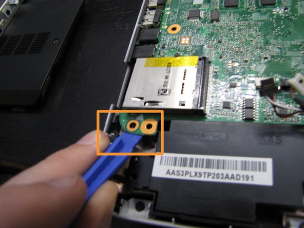

    • We are almost done with the top of the motherboard - just slide the two opposite-colored connectors south. May need a little wiggle to convince them fully.

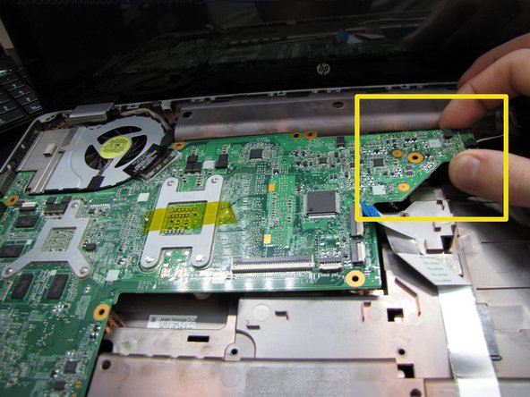

    • We will now attempt to start lifting the motherboard - DON'T USE PRESSURE! We still have cables from the bottom to remove
    • Start by putting your lifting tool between the casing and the bottom of the motherboard - you have to "lift" it off this peg to be able to move it further
    • Grab the far right side of the board and start lifting straight up about a "quarter-inch" - it will expose the bottom motherboard connections
  11. HP Pavilion dv7 Heat Sink Replacement: crwdns2935265:011crwdnd2935265:01crwdnd2935265:02crwdne2935265:0 HP Pavilion dv7 Heat Sink Replacement: crwdns2935265:011crwdnd2935265:02crwdnd2935265:02crwdne2935265:0

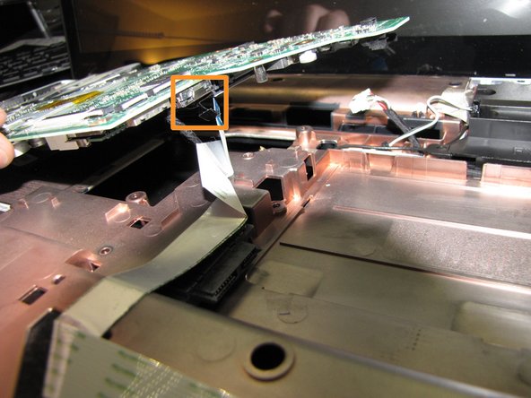

    • Underneath the far right side of the motherboard, you'll see another slide connector - pull it to the right
    • I originally forgot to pull out the other end of the hard drive connector - to simplify matters, pull straight down from the motherboard using the pull tab
    • That's all that should be securing the motherboard - now to remove, slowly wiggle motherboard while pulling it right - the left-side accessory plugs need to clear the side of the case. Once they are far enough away, use your left hand to pull the left side of the motherboard up - eventually it should just freely pull off of the case.
