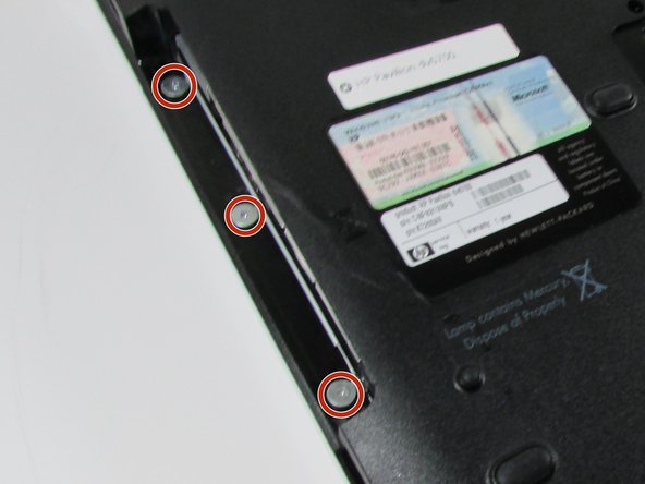

  4. HP Pavilion dv6700 Heat Sink Replacement: crwdns2935265:04crwdnd2935265:01crwdnd2935265:02crwdne2935265:0 HP Pavilion dv6700 Heat Sink Replacement: crwdns2935265:04crwdnd2935265:02crwdnd2935265:02crwdne2935265:0
    • Use a Phillips #00 screwdriver to remove the two screws securing Hard Disk Drive (HDD) cover.
    • Screws will not fully remove. Loosen them until they turn freely.

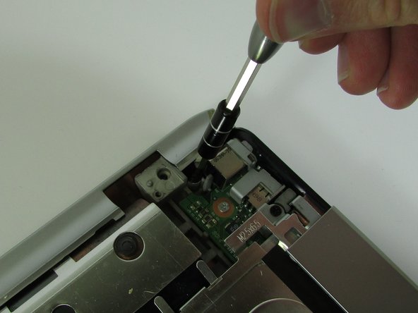

  7. HP Pavilion dv6700 Heat Sink Replacement: crwdns2935265:07crwdnd2935265:01crwdnd2935265:03crwdne2935265:0 HP Pavilion dv6700 Heat Sink Replacement: crwdns2935265:07crwdnd2935265:02crwdnd2935265:03crwdne2935265:0 HP Pavilion dv6700 Heat Sink Replacement: crwdns2935265:07crwdnd2935265:03crwdnd2935265:03crwdne2935265:0
    • Using the Phillips #0 screwdriver remove the 2 screws.
    • Use a needle-nose pliers to do the initial loosening, then switch to using a hex screwdriver (size 5) head to do the rest of the loosening.

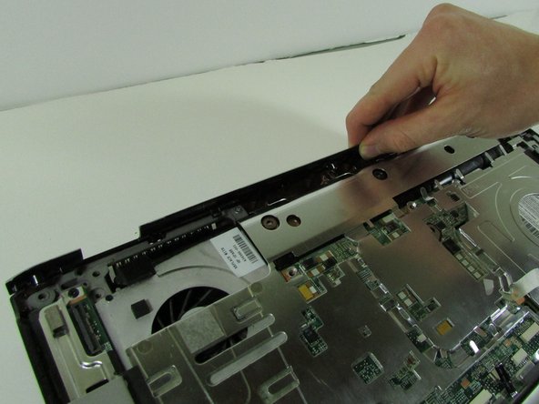

  9. HP Pavilion dv6700 Heat Sink Replacement: crwdns2935265:09crwdnd2935265:01crwdnd2935265:03crwdne2935265:0 HP Pavilion dv6700 Heat Sink Replacement: crwdns2935265:09crwdnd2935265:02crwdnd2935265:03crwdne2935265:0 HP Pavilion dv6700 Heat Sink Replacement: crwdns2935265:09crwdnd2935265:03crwdnd2935265:03crwdne2935265:0
    • Use an iFixit opening tool to pry open the plastic bar above the keyboard.
    • Be careful not to yank so hard that you rip out the ribbon cables underneath. There is enough room to pull safely, but use control to prevent damage.

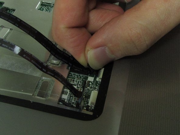

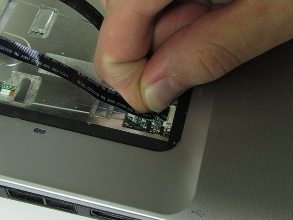

  12. HP Pavilion dv6700 Heat Sink Replacement: crwdns2935265:012crwdnd2935265:01crwdnd2935265:03crwdne2935265:0 HP Pavilion dv6700 Heat Sink Replacement: crwdns2935265:012crwdnd2935265:02crwdnd2935265:03crwdne2935265:0 HP Pavilion dv6700 Heat Sink Replacement: crwdns2935265:012crwdnd2935265:03crwdnd2935265:03crwdne2935265:0
    • Detach the ribbon cables.
    • Pull from the area closest to the connection port gently but firmly.

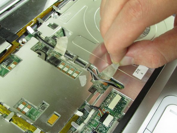

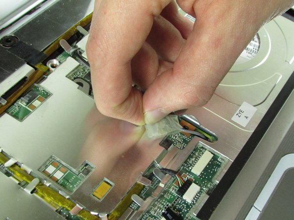

  13. HP Pavilion dv6700 Heat Sink Replacement: crwdns2935265:013crwdnd2935265:01crwdnd2935265:03crwdne2935265:0 HP Pavilion dv6700 Heat Sink Replacement: crwdns2935265:013crwdnd2935265:02crwdnd2935265:03crwdne2935265:0 HP Pavilion dv6700 Heat Sink Replacement: crwdns2935265:013crwdnd2935265:03crwdnd2935265:03crwdne2935265:0
    • Pull up on tape holding down wires.
  14. HP Pavilion dv6700 Heat Sink Replacement: crwdns2935265:014crwdnd2935265:01crwdnd2935265:03crwdne2935265:0 HP Pavilion dv6700 Heat Sink Replacement: crwdns2935265:014crwdnd2935265:02crwdnd2935265:03crwdne2935265:0 HP Pavilion dv6700 Heat Sink Replacement: crwdns2935265:014crwdnd2935265:03crwdnd2935265:03crwdne2935265:0

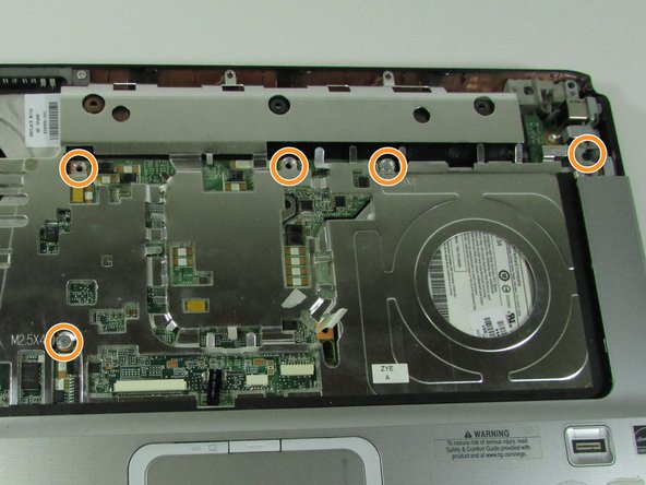

  20. HP Pavilion dv6700 Heat Sink Replacement: crwdns2935265:020crwdnd2935265:01crwdnd2935265:03crwdne2935265:0 HP Pavilion dv6700 Heat Sink Replacement: crwdns2935265:020crwdnd2935265:02crwdnd2935265:03crwdne2935265:0 HP Pavilion dv6700 Heat Sink Replacement: crwdns2935265:020crwdnd2935265:03crwdnd2935265:03crwdne2935265:0
    • Remove the screw in top left corner using the Phillips #00 screwdriver
    • Remove the five screws that are located on the motherboard cover.
    • Pull up on the cover to remove it.
    • You can use a plastic opener if it is hard to get your fingers under the cover's edges.
    • Do not pull hard on the cover, as there are two ribbon cables under the cover connected to the motherboard.

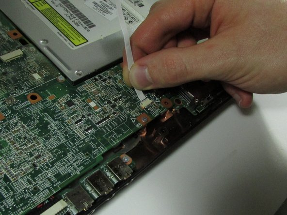

  21. HP Pavilion dv6700 Heat Sink Replacement: crwdns2935265:021crwdnd2935265:01crwdnd2935265:03crwdne2935265:0 HP Pavilion dv6700 Heat Sink Replacement: crwdns2935265:021crwdnd2935265:02crwdnd2935265:03crwdne2935265:0 HP Pavilion dv6700 Heat Sink Replacement: crwdns2935265:021crwdnd2935265:03crwdnd2935265:03crwdne2935265:0
    • Pull gently but firmly on the ribbon cables at the connection points to remove them

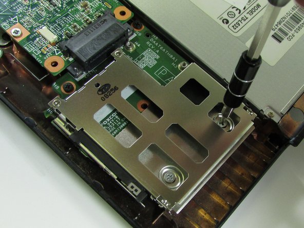

  22. HP Pavilion dv6700 Heat Sink Replacement: crwdns2935265:022crwdnd2935265:01crwdnd2935265:03crwdne2935265:0 HP Pavilion dv6700 Heat Sink Replacement: crwdns2935265:022crwdnd2935265:02crwdnd2935265:03crwdne2935265:0 HP Pavilion dv6700 Heat Sink Replacement: crwdns2935265:022crwdnd2935265:03crwdnd2935265:03crwdne2935265:0
    • Remove the four screws from the ExpressCard component using the Phillips #00 screwdriver.
  23. HP Pavilion dv6700 Heat Sink Replacement: crwdns2935265:023crwdnd2935265:01crwdnd2935265:03crwdne2935265:0 HP Pavilion dv6700 Heat Sink Replacement: crwdns2935265:023crwdnd2935265:02crwdnd2935265:03crwdne2935265:0 HP Pavilion dv6700 Heat Sink Replacement: crwdns2935265:023crwdnd2935265:03crwdnd2935265:03crwdne2935265:0
    • Remove ExpressCard component by sliding it out.
    • Remove Optical Drive by sliding it out.

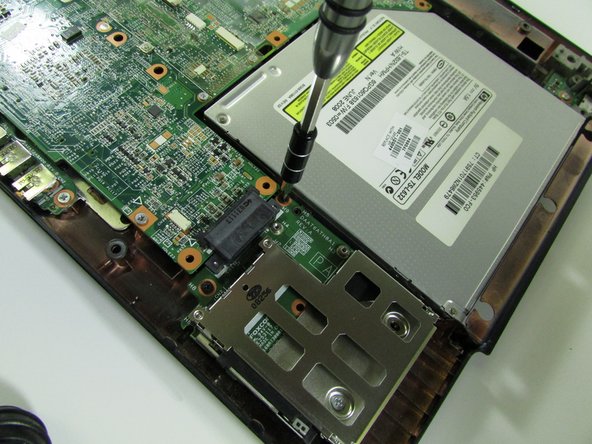

  24. HP Pavilion dv6700 Heat Sink Replacement: crwdns2935265:024crwdnd2935265:01crwdnd2935265:02crwdne2935265:0 HP Pavilion dv6700 Heat Sink Replacement: crwdns2935265:024crwdnd2935265:02crwdnd2935265:02crwdne2935265:0
    • Detach connector from the motherboard.
    • This piece is likely to be very hard to disconnect, so do not be afraid to use more force than normal.
  25. HP Pavilion dv6700 Heat Sink Replacement: crwdns2935265:025crwdnd2935265:01crwdnd2935265:01crwdne2935265:0
    • Using the Phillips #00 screwdriver, remove the one screw near where the ExpressCard component was.

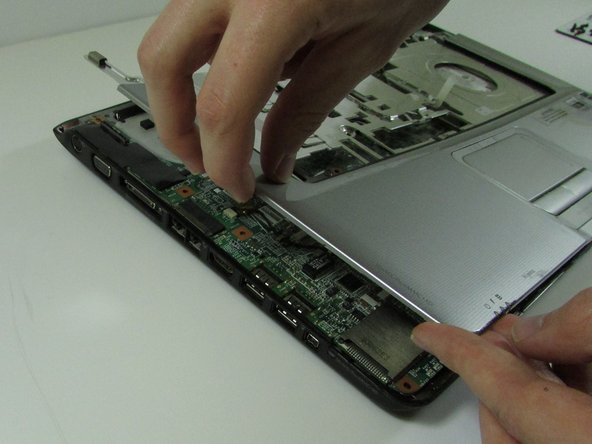

  26. HP Pavilion dv6700 Heat Sink Replacement: crwdns2935265:026crwdnd2935265:01crwdnd2935265:03crwdne2935265:0 HP Pavilion dv6700 Heat Sink Replacement: crwdns2935265:026crwdnd2935265:02crwdnd2935265:03crwdne2935265:0 HP Pavilion dv6700 Heat Sink Replacement: crwdns2935265:026crwdnd2935265:03crwdnd2935265:03crwdne2935265:0

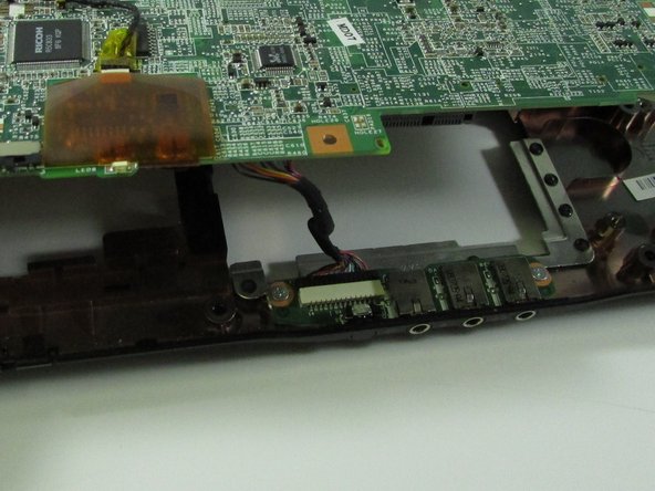

    • Lift up motherboard.
    • Detach the motherboard connector at the front under the motherboard.
  27. HP Pavilion dv6700 Heat Sink Replacement: crwdns2935265:027crwdnd2935265:01crwdnd2935265:03crwdne2935265:0 HP Pavilion dv6700 Heat Sink Replacement: crwdns2935265:027crwdnd2935265:02crwdnd2935265:03crwdne2935265:0 HP Pavilion dv6700 Heat Sink Replacement: crwdns2935265:027crwdnd2935265:03crwdnd2935265:03crwdne2935265:0
    • Lift up and out the motherboard.
    • Detach the connector under the motherboard.
    • Remove the motherboard.

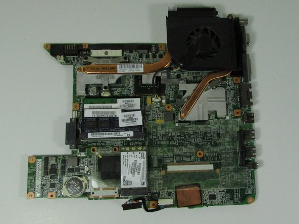

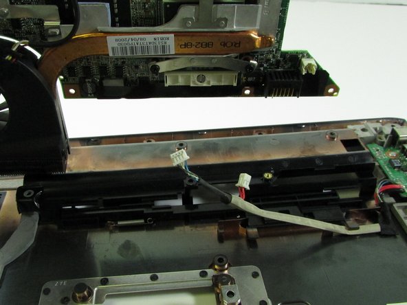

  28. HP Pavilion dv6700 Heat Sink Replacement, Heat Sink: crwdns2935265:028crwdnd2935265:01crwdnd2935265:01crwdne2935265:0
    • Use a Phillips #0 screwdriver to loosen the 5 screws securing the heat sink to the motherboard.
    • The screws will not come out of the heat sink - just out of the motherboard.
  29. HP Pavilion dv6700 Heat Sink Replacement: crwdns2935265:029crwdnd2935265:01crwdnd2935265:01crwdne2935265:0
    • Disconnect the fan connector from the port on the motherboard.
  30. HP Pavilion dv6700 Heat Sink Replacement: crwdns2935265:030crwdnd2935265:01crwdnd2935265:01crwdne2935265:0
