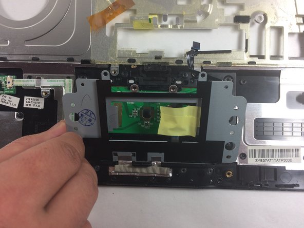

  9. HP Pavilion dv6500 Touchpad Replacement: crwdns2935265:09crwdnd2935265:01crwdnd2935265:01crwdne2935265:0
    • Remove the 4 7mm screws holding the metal plate to the rest of the laptop.
    • Lift the metal plate off the laptop and turn over to reveal the underside of the mouse pad

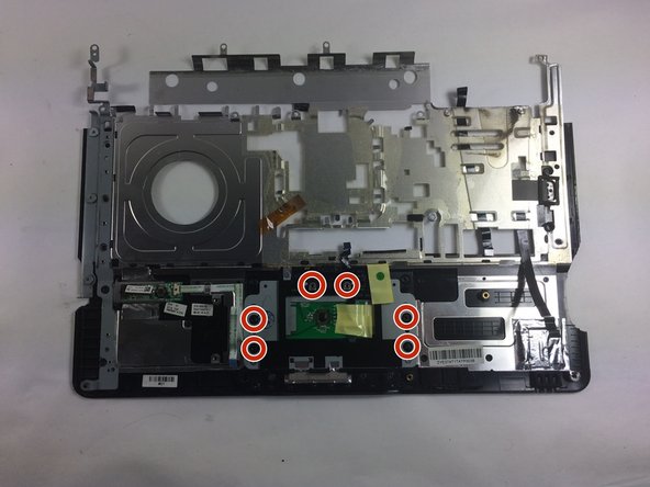

  10. HP Pavilion dv6500 Touchpad Replacement: crwdns2935265:010crwdnd2935265:01crwdnd2935265:03crwdne2935265:0 HP Pavilion dv6500 Touchpad Replacement: crwdns2935265:010crwdnd2935265:02crwdnd2935265:03crwdne2935265:0 HP Pavilion dv6500 Touchpad Replacement: crwdns2935265:010crwdnd2935265:03crwdnd2935265:03crwdne2935265:0
    • Flip the metal plate over to expose the screws holding the keypad in place.
    • Remove the 6 7.0mm screws holding the mousepad in place.
  11. HP Pavilion dv6500 Touchpad Replacement: crwdns2935265:011crwdnd2935265:01crwdnd2935265:01crwdne2935265:0
    • Remove the 4 7mm screws, 2 on either side of the mouse pad.
