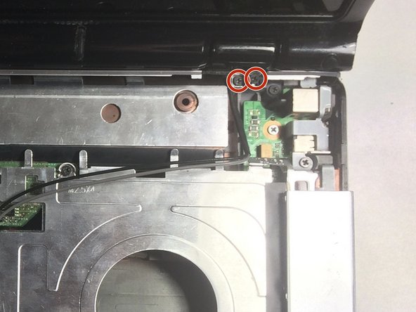

  8. HP Pavilion dv6500 Screen Replacement, Screen: crwdns2935265:08crwdnd2935265:01crwdnd2935265:03crwdne2935265:0 HP Pavilion dv6500 Screen Replacement, Screen: crwdns2935265:08crwdnd2935265:02crwdnd2935265:03crwdne2935265:0 HP Pavilion dv6500 Screen Replacement, Screen: crwdns2935265:08crwdnd2935265:03crwdnd2935265:03crwdne2935265:0
    • Remove the four 7mm screws holding screen to keyboard, there are 2 on each side.

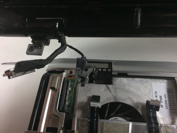

  9. HP Pavilion dv6500 Screen Replacement: crwdns2935265:09crwdnd2935265:01crwdnd2935265:03crwdne2935265:0 HP Pavilion dv6500 Screen Replacement: crwdns2935265:09crwdnd2935265:02crwdnd2935265:03crwdne2935265:0 HP Pavilion dv6500 Screen Replacement: crwdns2935265:09crwdnd2935265:03crwdnd2935265:03crwdne2935265:0
    • Unplug all cables connected to the monitor on the left side. The thick black cable should come out with a simple tug.
    • Turn over laptop and unscrew 7mm fastener holding wires in place and pull the wires through the laptop to the other side.
  10. HP Pavilion dv6500 Screen Replacement: crwdns2935265:010crwdnd2935265:01crwdnd2935265:01crwdne2935265:0
    • Feed the cables through the laptop and lift the monitor from the rest of the computer.
