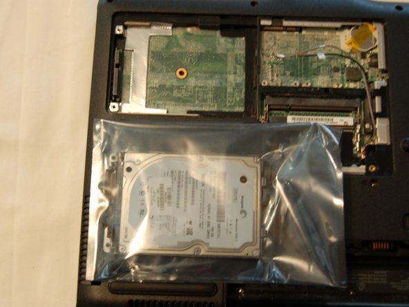

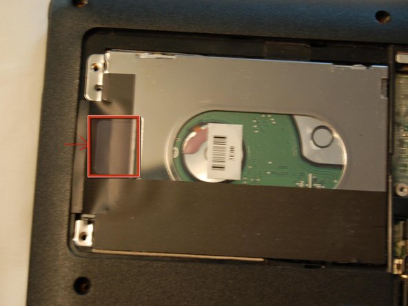

  4. HP Pavilion dv6000 Teardown: crwdns2935265:04crwdnd2935265:01crwdnd2935265:03crwdne2935265:0 HP Pavilion dv6000 Teardown: crwdns2935265:04crwdnd2935265:02crwdnd2935265:03crwdne2935265:0 HP Pavilion dv6000 Teardown: crwdns2935265:04crwdnd2935265:03crwdnd2935265:03crwdne2935265:0
    • Remove the two screws from the hard drive shield and lift off.
    • Lift out the hard drive by grasping the plastic tab and pulling gently. Place in an anti-static bag.

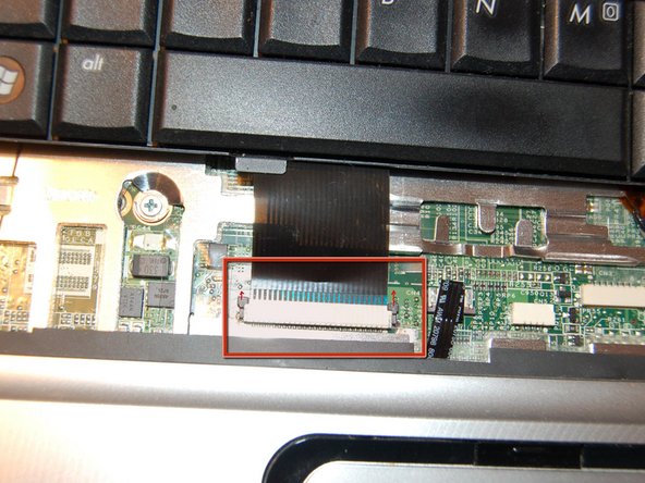

  8. HP Pavilion dv6000 Teardown: crwdns2935265:08crwdnd2935265:01crwdnd2935265:03crwdne2935265:0 HP Pavilion dv6000 Teardown: crwdns2935265:08crwdnd2935265:02crwdnd2935265:03crwdne2935265:0 HP Pavilion dv6000 Teardown: crwdns2935265:08crwdnd2935265:03crwdnd2935265:03crwdne2935265:0

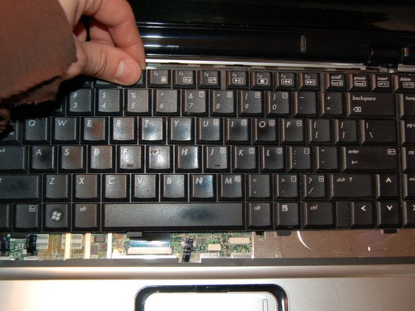

    • Lift up the back of the keyboard and slide it slowly towards the screen. Unclip the ribbon cable near the touchpad. Set the keyboard aside.

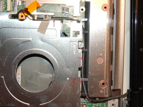

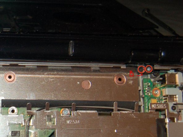

    • Time to take off the screen.
    • A. Remove the screw on the left that holds the clip down, unclip it.
    • B. Remove the four screws at the base of the screen, and lift out, taking care with the antenna wires on the right.
    • C. Thread them out of the clips, towards the touchpad. You can then pull them through the board, checking on the bottom to make sure they’re free.

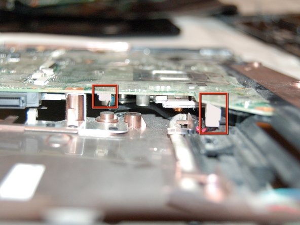

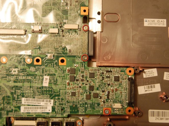

  12. HP Pavilion dv6000 Teardown: crwdns2935265:012crwdnd2935265:01crwdnd2935265:03crwdne2935265:0 HP Pavilion dv6000 Teardown: crwdns2935265:012crwdnd2935265:02crwdnd2935265:03crwdne2935265:0 HP Pavilion dv6000 Teardown: crwdns2935265:012crwdnd2935265:03crwdnd2935265:03crwdne2935265:0
    • Remove these four screws, and pull the express card module away from the motherboard.
    • Remove these three screws, and then these clips, (you can get at them better after you remove the screws, and the larger of the two should come apart first) and lift the board away from the shell, taking care with the audio jack cable.
