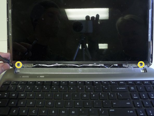

    2. HP Pavilion dv6-6180us Screen Replacement: crwdns2935265:08crwdnd2935265:01crwdnd2935265:01crwdne2935265:0
      • Unscrew two 6mm screws using PH1 screwdriver.
    3. HP Pavilion dv6-6180us Screen Replacement: crwdns2935265:09crwdnd2935265:01crwdnd2935265:01crwdne2935265:0

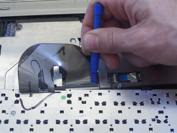

      • Place keyboard upside down.
      • Lift up plastic cover over keyboard connector cable.

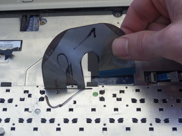

      • Pull ribbon cable up away from keyboard to completely remove.

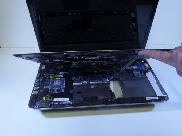

    9. HP Pavilion dv6-6180us Screen Replacement: crwdns2935265:015crwdnd2935265:01crwdnd2935265:01crwdne2935265:0
      • Place the computer on its side.
      • Separate top panel from bottom frame.
    10. HP Pavilion dv6-6180us Screen Replacement: crwdns2935265:016crwdnd2935265:01crwdnd2935265:02crwdne2935265:0 HP Pavilion dv6-6180us Screen Replacement: crwdns2935265:016crwdnd2935265:02crwdnd2935265:02crwdne2935265:0
      • Pop open rest palm assembly.

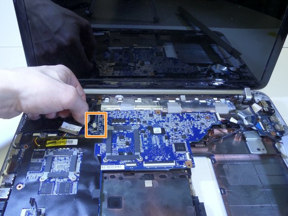

    15. HP Pavilion dv6-6180us Screen Replacement: crwdns2935265:021crwdnd2935265:01crwdnd2935265:02crwdne2935265:0 HP Pavilion dv6-6180us Screen Replacement: crwdns2935265:021crwdnd2935265:02crwdnd2935265:02crwdne2935265:0
      • Grab tab on left top corner and remove black wire.
      • Remove white input attachment.
