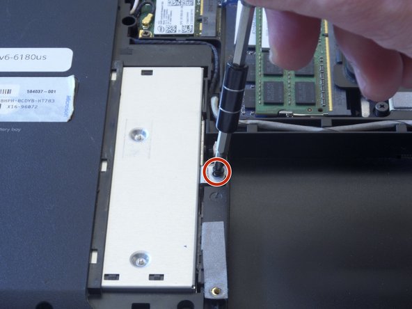

  7. HP Pavilion dv6-6180us Motherboard Replacement, Motherboard: crwdns2935265:07crwdnd2935265:01crwdnd2935265:02crwdne2935265:0 HP Pavilion dv6-6180us Motherboard Replacement, Motherboard: crwdns2935265:07crwdnd2935265:02crwdnd2935265:02crwdne2935265:0
    • Remove a 3.5 mm screw that is securing DVD player with screwdriver PH1.

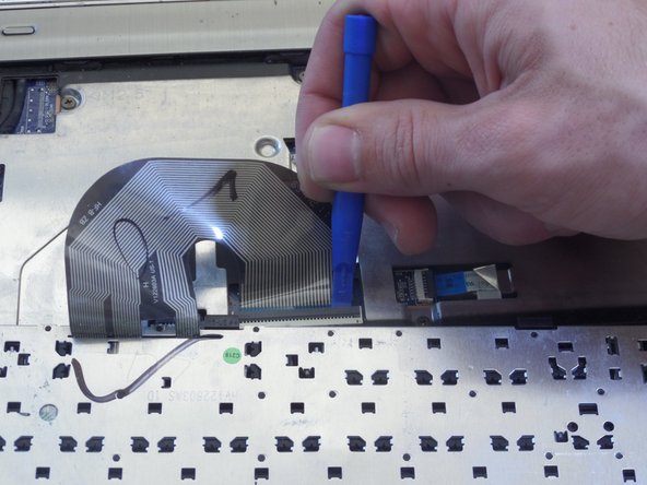

  10. HP Pavilion dv6-6180us Motherboard Replacement: crwdns2935265:010crwdnd2935265:01crwdnd2935265:02crwdne2935265:0 HP Pavilion dv6-6180us Motherboard Replacement: crwdns2935265:010crwdnd2935265:02crwdnd2935265:02crwdne2935265:0
    • Flip side up and open laptop.
    • Pry open the keyboard using a plastic opening tool starting from the top.
    • Lift up keyboard gently because a silver ribbon is still attaching it to the laptop.

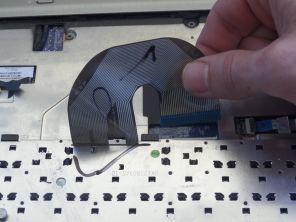

  11. HP Pavilion dv6-6180us Motherboard Replacement: crwdns2935265:011crwdnd2935265:01crwdnd2935265:03crwdne2935265:0 HP Pavilion dv6-6180us Motherboard Replacement: crwdns2935265:011crwdnd2935265:02crwdnd2935265:03crwdne2935265:0 HP Pavilion dv6-6180us Motherboard Replacement: crwdns2935265:011crwdnd2935265:03crwdnd2935265:03crwdne2935265:0
    • Place keyboard upside down.
    • Lift up plastic cover over keyboard connector cable.
    • Pull ribbon cable up away from keyboard to completely remove.

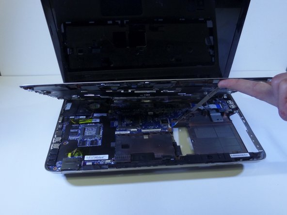

  14. HP Pavilion dv6-6180us Motherboard Replacement: crwdns2935265:014crwdnd2935265:01crwdnd2935265:02crwdne2935265:0 HP Pavilion dv6-6180us Motherboard Replacement: crwdns2935265:014crwdnd2935265:02crwdnd2935265:02crwdne2935265:0
    • Pop open rest palm assembly.
