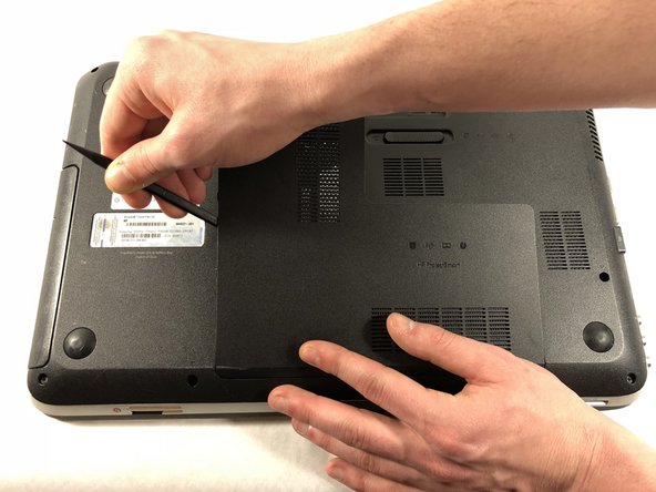

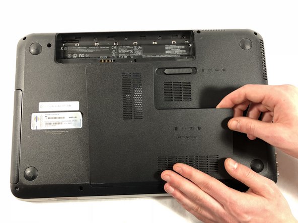

    • Begin removing the bottom cover by sliding the battery removal slider to the right to pop off the top of the cover.
  2. HP Pavilion dv6-6117dx WiFi Adapter Replacement: crwdns2935265:02crwdnd2935265:01crwdnd2935265:02crwdne2935265:0 HP Pavilion dv6-6117dx WiFi Adapter Replacement: crwdns2935265:02crwdnd2935265:02crwdnd2935265:02crwdne2935265:0
    • Slide a black spudger under the top of the cover to loosen the clips underneath.
  3. HP Pavilion dv6-6117dx WiFi Adapter Replacement: crwdns2935265:03crwdnd2935265:01crwdnd2935265:03crwdne2935265:0 HP Pavilion dv6-6117dx WiFi Adapter Replacement: crwdns2935265:03crwdnd2935265:02crwdnd2935265:03crwdne2935265:0 HP Pavilion dv6-6117dx WiFi Adapter Replacement: crwdns2935265:03crwdnd2935265:03crwdnd2935265:03crwdne2935265:0
    • Slide the spudger down the left side of the cover to loosen the clips.
    • After the left side is loose, the rest of the cover should pop off, and you can remove it with your hands.
    • When reassembling, insert the bottom of the cover first, and then firmly press along the edges from bottom to top to secure it in place.

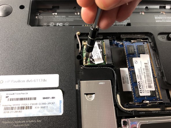

    • Using a spudger, remove the white and black antenna wires from the WiFi Adapter
    • When connecting these wires later, line up the connector and press straight down until you feel them snap in place.
  5. HP Pavilion dv6-6117dx WiFi Adapter Replacement: crwdns2935265:05crwdnd2935265:01crwdnd2935265:03crwdne2935265:0 HP Pavilion dv6-6117dx WiFi Adapter Replacement: crwdns2935265:05crwdnd2935265:02crwdnd2935265:03crwdne2935265:0 HP Pavilion dv6-6117dx WiFi Adapter Replacement: crwdns2935265:05crwdnd2935265:03crwdnd2935265:03crwdne2935265:0
    • Using a Phillips #0 screw driver, remove the two 4mm screws holding the WiFi adapter in place
    • After the screws are removed the WiFi Adapter will raise to a 45º angle.
  6. HP Pavilion dv6-6117dx WiFi Adapter Replacement: crwdns2935265:06crwdnd2935265:01crwdnd2935265:02crwdne2935265:0 HP Pavilion dv6-6117dx WiFi Adapter Replacement: crwdns2935265:06crwdnd2935265:02crwdnd2935265:02crwdne2935265:0
    • Always handle the WiFi Adapter by the edges to avoid damaging the part.
    • Pull the WiFi Adapter out of the slot at a 45º angle.
    • When inserting the new WiFi Adapter, you should insert it at this same angle.
