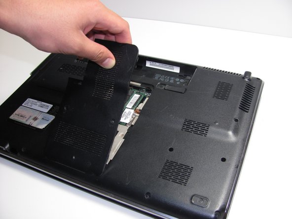

    • Using the Phillips #1, loosen the three 7mm captive screws that secure the memory module cover to the computer.
  3. HP Pavilion dv6-2158nr RAM Replacement: crwdns2935265:03crwdnd2935265:01crwdnd2935265:03crwdne2935265:0 HP Pavilion dv6-2158nr RAM Replacement: crwdns2935265:03crwdnd2935265:02crwdnd2935265:03crwdne2935265:0 HP Pavilion dv6-2158nr RAM Replacement: crwdns2935265:03crwdnd2935265:03crwdnd2935265:03crwdne2935265:0
    • Remove cover and expose the memory module by lifting the cover up like its on a hinge.

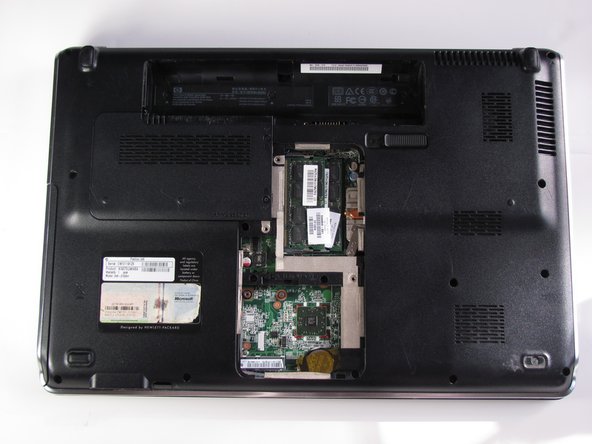

    • Locate the release tabs on both sides of the RAM.
    • Use non-conductive pointing tool or fingers to prevent static build up and damaging components.
    • Pull the metal tabs away from the memory to release it.
    • Pull RAM away from clips to remove from device
    • Repeat for second RAM if necessary
