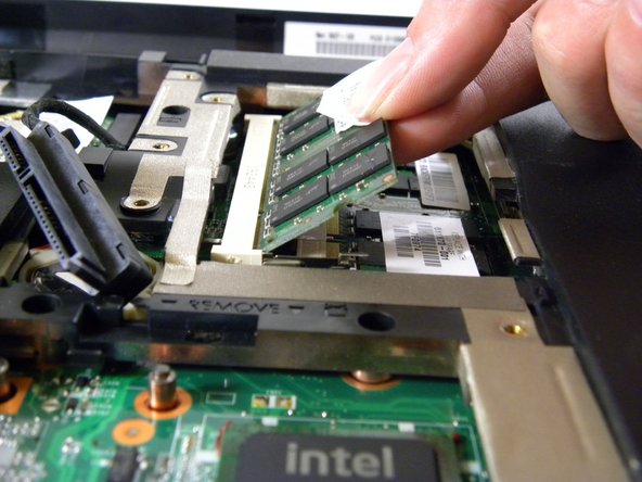

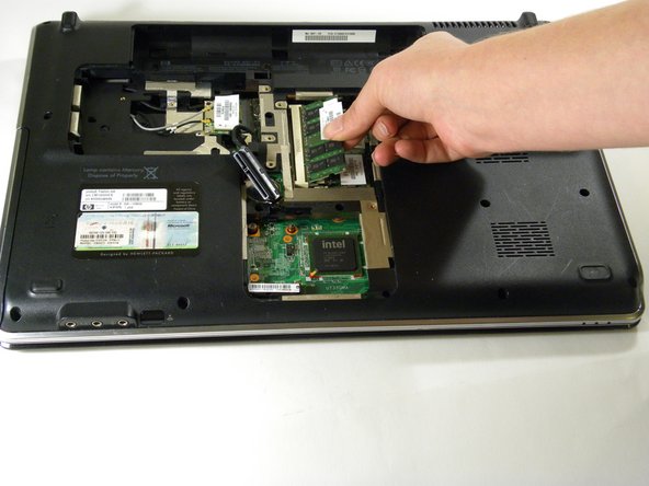

  5. HP Pavilion dv6-1245dx RAM Replacement: crwdns2935265:05crwdnd2935265:01crwdnd2935265:03crwdne2935265:0 HP Pavilion dv6-1245dx RAM Replacement: crwdns2935265:05crwdnd2935265:02crwdnd2935265:03crwdne2935265:0 HP Pavilion dv6-1245dx RAM Replacement: crwdns2935265:05crwdnd2935265:03crwdnd2935265:03crwdne2935265:0
    • Remove the first memory module by spreading apart the two silver retaining tabs, using your thumb and index finger.
    • Pull and lift the green memory module upward at a 45-degree angle, and then pull the memory module out of the computer.
    • If you are replacing both memory cards, repeat this step with the bottom memory card.
  6. HP Pavilion dv6-1245dx RAM Replacement: crwdns2935265:06crwdnd2935265:01crwdnd2935265:01crwdne2935265:0
    • To replace the memory card, insert the card at a 45-degree angle, then push into slot.
    • Push down gently so the silver retaining tabs click back into place.
    • If you are replacing both memory cards, replace the bottom card (closest to the system board) first.
