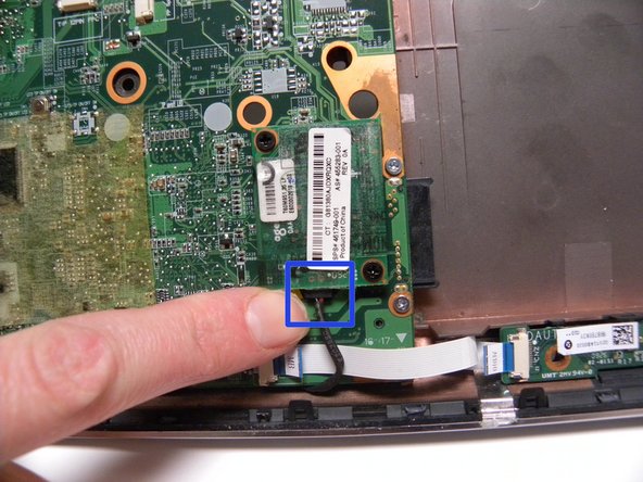

  34. HP Pavilion dv6-1245dx Fan Replacement, Fan: crwdns2935265:034crwdnd2935265:01crwdnd2935265:02crwdne2935265:0 HP Pavilion dv6-1245dx Fan Replacement, Fan: crwdns2935265:034crwdnd2935265:02crwdnd2935265:02crwdne2935265:0
    • Orient the computer so that the display assembly area is facing away from you.
    • Disconnect the modem cable from the green modem module by using your thumb and forefinger to free the black connector from the modem module.
    • You may need to move the modem cable back and forth several times to release it.
