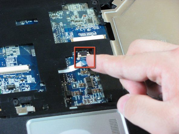

  20. HP Pavilion dv5000 Trackpad  Replacement: crwdns2935265:020crwdnd2935265:01crwdnd2935265:02crwdne2935265:0 HP Pavilion dv5000 Trackpad  Replacement: crwdns2935265:020crwdnd2935265:02crwdnd2935265:02crwdne2935265:0
    • Flip the computer over and disconnect the Touchpad Cable.

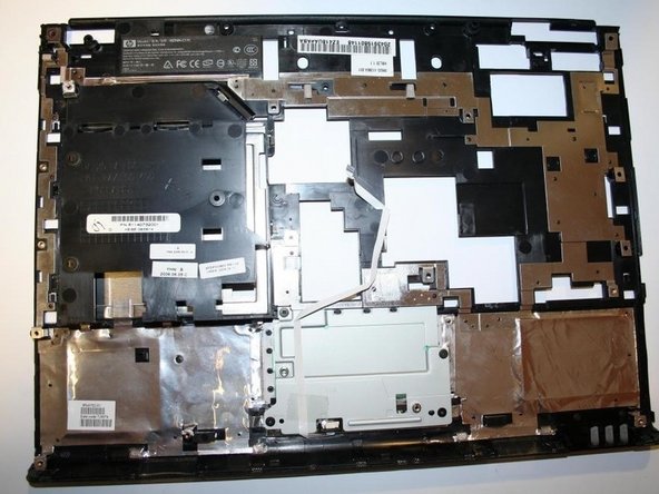

  22. HP Pavilion dv5000 Trackpad  Replacement: crwdns2935265:022crwdnd2935265:01crwdnd2935265:01crwdne2935265:0
    • Lift off the top cover and remove it. Lift off from the back.
  23. HP Pavilion dv5000 Trackpad  Replacement: crwdns2935265:023crwdnd2935265:01crwdnd2935265:02crwdne2935265:0 HP Pavilion dv5000 Trackpad  Replacement: crwdns2935265:023crwdnd2935265:02crwdnd2935265:02crwdne2935265:0
    • Congratulations! You're ready to install the new assembly and reassemble your laptop!
