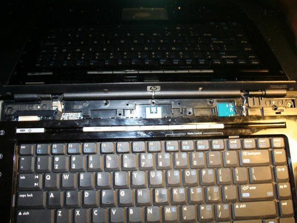

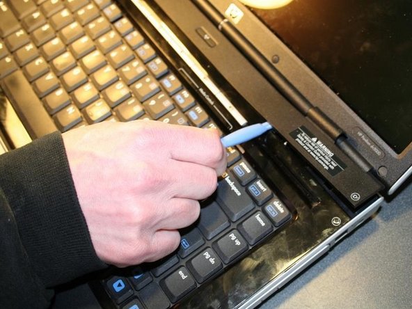

    • Lift plastic covering strip gently at the corner to separate the plastic it from the keyboard area.
    • Slide a plastic separator tool along the strip and lift off to remove it.

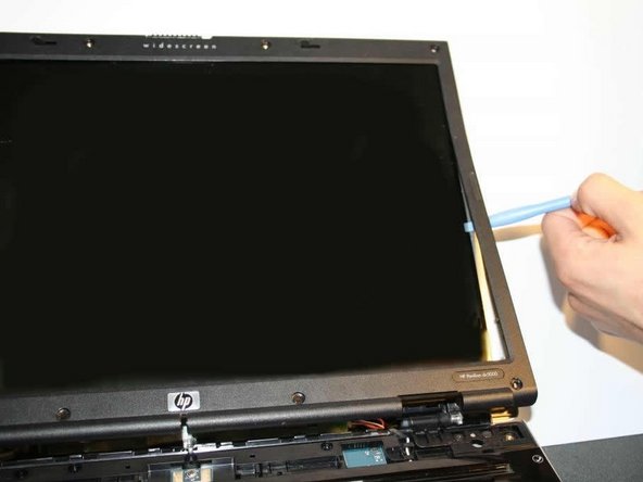

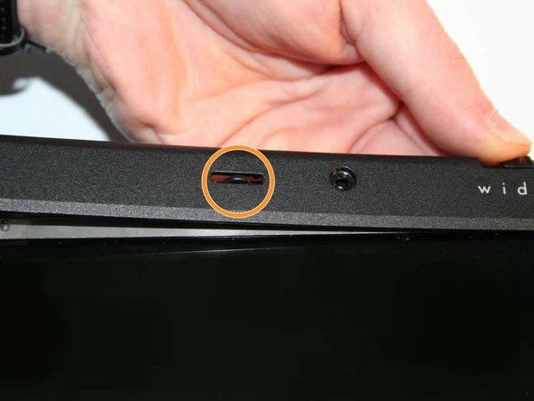

    • Using the plastic separator, make your way up from the bottom, separating the screen's frame off.
    • You may need to finagle the locking tab slightly in order to pull the frame away from it

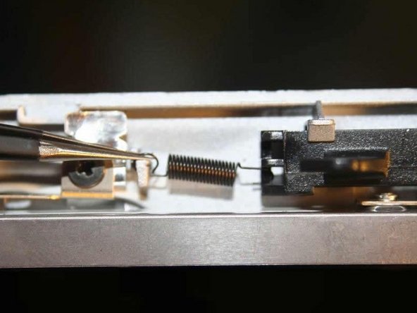

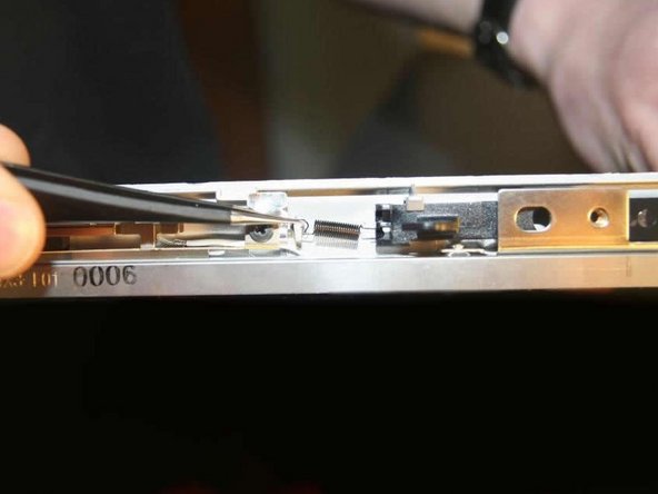

    • With frame removed, the locking assembly is visible
    • Using tweezers, pull the spring off the hook, and the locking assembly will pull down and off with little effort
    • Be sure not to drop the spring behind the screen while removing it!
