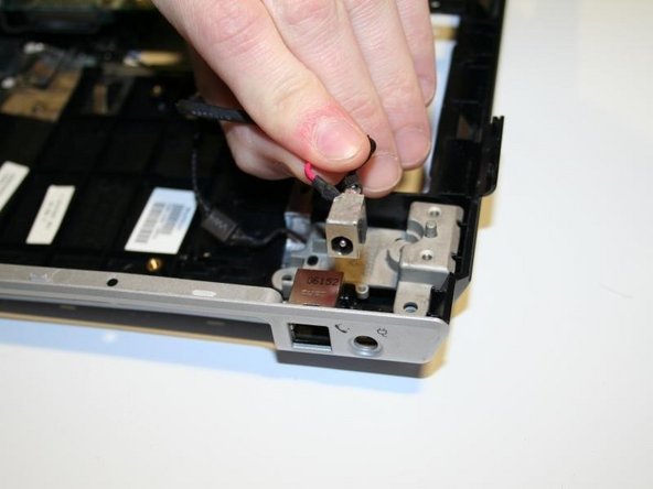

  26. HP Pavilion dv5000 Power Supply Port Replacement, Power Supply Port: crwdns2935265:026crwdnd2935265:01crwdnd2935265:02crwdne2935265:0 HP Pavilion dv5000 Power Supply Port Replacement, Power Supply Port: crwdns2935265:026crwdnd2935265:02crwdnd2935265:02crwdne2935265:0
    • Locate the Power Supply Port
    • Lift the port up to remove it from its seated position
