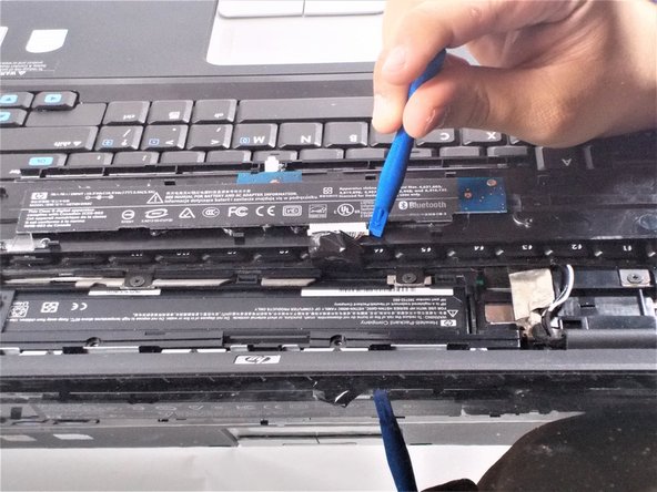

  5. HP Pavilion dv4000 Keyboard Replacement: crwdns2935265:05crwdnd2935265:01crwdnd2935265:01crwdne2935265:0
    • Using a metal spudger, pry up on the plastic piece above the keyboard containing the power button.
    • Be careful not to damage any components with the tool while prying.

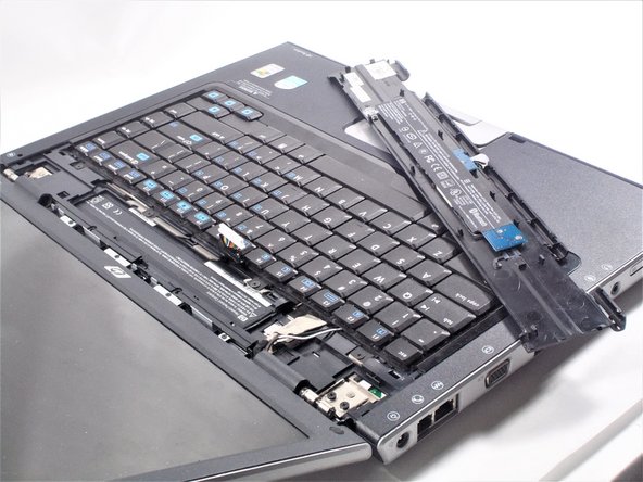

  6. HP Pavilion dv4000 Keyboard Replacement: crwdns2935265:06crwdnd2935265:01crwdnd2935265:01crwdne2935265:0
    • Lift the plastic piece up.
    • When lifting this piece, be careful not to damage the ribbon strip connected to it.
  7. HP Pavilion dv4000 Keyboard Replacement: crwdns2935265:07crwdnd2935265:01crwdnd2935265:03crwdne2935265:0 HP Pavilion dv4000 Keyboard Replacement: crwdns2935265:07crwdnd2935265:02crwdnd2935265:03crwdne2935265:0 HP Pavilion dv4000 Keyboard Replacement: crwdns2935265:07crwdnd2935265:03crwdnd2935265:03crwdne2935265:0
    • Place the plastic piece on the keyboard so the ribbon strip is easily accessible.
    • Carefully disconnect the ribbon strip from the keyboard by pressing on the tabs at the edges.
    • Remove plastic piece and set aside.

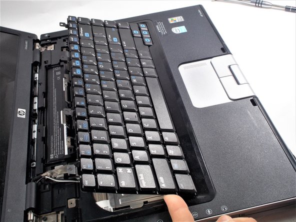

  10. HP Pavilion dv4000 Keyboard Replacement: crwdns2935265:010crwdnd2935265:01crwdnd2935265:02crwdne2935265:0 HP Pavilion dv4000 Keyboard Replacement: crwdns2935265:010crwdnd2935265:02crwdnd2935265:02crwdne2935265:0
    • Lift the keyboard up.
    • When lifting the keyboard, be sure not to damage the ribbon strip that is connected to it.

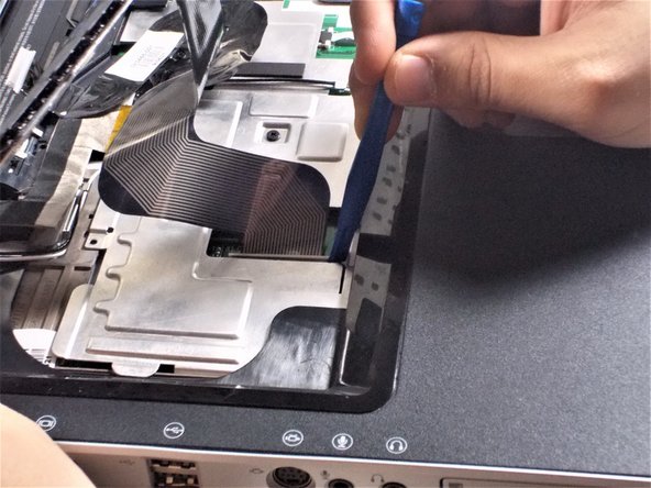

  11. HP Pavilion dv4000 Keyboard Replacement: crwdns2935265:011crwdnd2935265:01crwdnd2935265:01crwdne2935265:0
    • Locate where the ribbon strip is connected to the motherboard.
  12. HP Pavilion dv4000 Keyboard Replacement: crwdns2935265:012crwdnd2935265:01crwdnd2935265:02crwdne2935265:0 HP Pavilion dv4000 Keyboard Replacement: crwdns2935265:012crwdnd2935265:02crwdnd2935265:02crwdne2935265:0
    • Pry at the edges of the plastic clip holding the ribbon cable to the motherboard.
    • Be careful during this step as these clips are very easy to break.

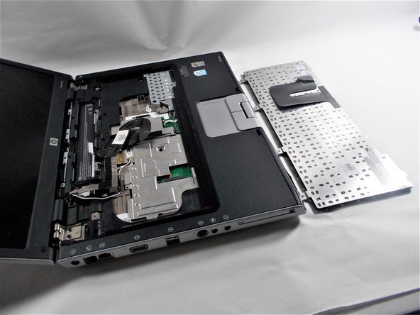

  13. HP Pavilion dv4000 Keyboard Replacement: crwdns2935265:013crwdnd2935265:01crwdnd2935265:03crwdne2935265:0 HP Pavilion dv4000 Keyboard Replacement: crwdns2935265:013crwdnd2935265:02crwdnd2935265:03crwdne2935265:0 HP Pavilion dv4000 Keyboard Replacement: crwdns2935265:013crwdnd2935265:03crwdnd2935265:03crwdne2935265:0
    • Remove the keyboard.
