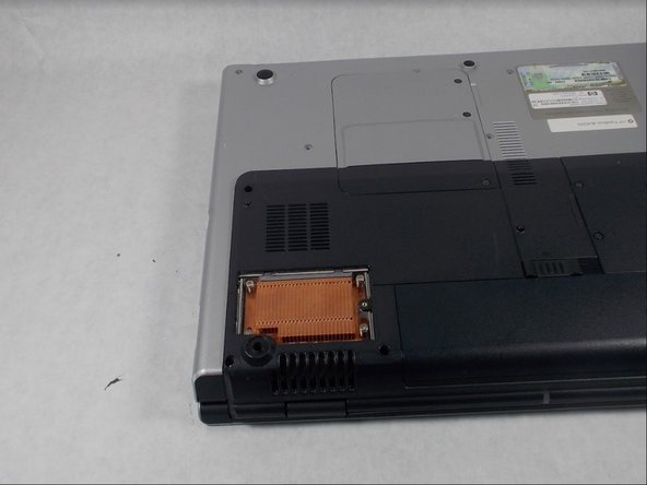

  4. HP Pavilion dv4000 Heat Sink Replacement, Heat Sink: crwdns2935265:04crwdnd2935265:01crwdnd2935265:01crwdne2935265:0
    • Position laptop with heat sink compartment facing you.
    • Locate the one 2x5 mm Torx screw.
  5. HP Pavilion dv4000 Heat Sink Replacement: crwdns2935265:05crwdnd2935265:01crwdnd2935265:01crwdne2935265:0
    • Remove the one 2x5 mm Torx screw securing the thermal cover with a #6 Torx screwdriver.
  6. HP Pavilion dv4000 Heat Sink Replacement: crwdns2935265:06crwdnd2935265:01crwdnd2935265:02crwdne2935265:0 HP Pavilion dv4000 Heat Sink Replacement: crwdns2935265:06crwdnd2935265:02crwdnd2935265:02crwdne2935265:0
    • Lift thermal cover to reveal heat sink.
    • Remove and set aside thermal cover.
  7. HP Pavilion dv4000 Heat Sink Replacement: crwdns2935265:07crwdnd2935265:01crwdnd2935265:02crwdne2935265:0 HP Pavilion dv4000 Heat Sink Replacement: crwdns2935265:07crwdnd2935265:02crwdnd2935265:02crwdne2935265:0
    • Locate the four screws on each corner of heat sink.
    • Unscrew the four 2x12 mm screws with a #00 Phillips screwdriver.
  8. HP Pavilion dv4000 Heat Sink Replacement: crwdns2935265:08crwdnd2935265:01crwdnd2935265:02crwdne2935265:0 HP Pavilion dv4000 Heat Sink Replacement: crwdns2935265:08crwdnd2935265:02crwdnd2935265:02crwdne2935265:0
    • Grab sides of heat sink and carefully lift from compartment.
    • Due to adhesive bonding of heat sink to base, wiggling it side to side before lifting might help removal process.
