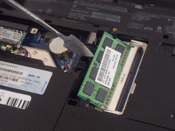

      • Lift up the back panel using a spudger and remove it from the device.
    2. HP Pavilion dv4-4141us RAM Replacement: crwdns2935265:02crwdnd2935265:01crwdnd2935265:01crwdne2935265:0
      • Push the two metal clips away from each other to release the RAM.
    3. HP Pavilion dv4-4141us RAM Replacement: crwdns2935265:03crwdnd2935265:01crwdnd2935265:02crwdne2935265:0 HP Pavilion dv4-4141us RAM Replacement: crwdns2935265:03crwdnd2935265:02crwdnd2935265:02crwdne2935265:0
      • Each RAM stick will pop up at a 45 degree angle.
      • Pull the RAM up and away and remove it from the device.
      • Do not use a metal spudger for this step. Incorrect use of the metal spudger can damage the internal components in your device.
