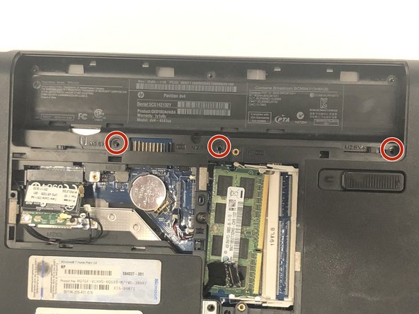

  1. HP Pavilion dv4-4141us Fan Replacement, Back Panel: crwdns2935265:01crwdnd2935265:01crwdnd2935265:01crwdne2935265:0
    • Lift up the back panel using a spudger, and remove it from the device.
  2. HP Pavilion dv4-4141us Fan Replacement: crwdns2935265:02crwdnd2935265:01crwdnd2935265:03crwdne2935265:0 HP Pavilion dv4-4141us Fan Replacement: crwdns2935265:02crwdnd2935265:02crwdnd2935265:03crwdne2935265:0 HP Pavilion dv4-4141us Fan Replacement: crwdns2935265:02crwdnd2935265:03crwdnd2935265:03crwdne2935265:0
    • Using the Phillips #1 screwdriver unscrew the panel from the computer.
    • Lift the panel up and remove it from the laptop.

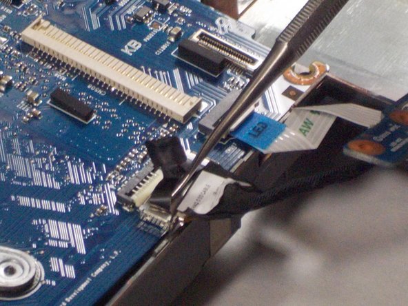

  6. HP Pavilion dv4-4141us Fan Replacement: crwdns2935265:06crwdnd2935265:01crwdnd2935265:01crwdne2935265:0
    • Use a spudger to gently lift the white plastic flap and release the ribbon cable holding the keyboard in place.
  7. HP Pavilion dv4-4141us Fan Replacement: crwdns2935265:07crwdnd2935265:01crwdnd2935265:02crwdne2935265:0 HP Pavilion dv4-4141us Fan Replacement: crwdns2935265:07crwdnd2935265:02crwdnd2935265:02crwdne2935265:0
    • Use the spudger to lift up the flap and release the cable for both of these two separate components.
    • Be extra careful not to break these clips as they are fragile and are a part of the motherboard.

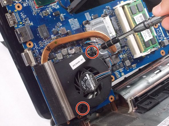

  9. HP Pavilion dv4-4141us Fan Replacement: crwdns2935265:09crwdnd2935265:01crwdnd2935265:02crwdne2935265:0 HP Pavilion dv4-4141us Fan Replacement: crwdns2935265:09crwdnd2935265:02crwdnd2935265:02crwdne2935265:0
    • Take out the mother board and flip it over so that you can access the fan.
    • Unscrew the two screws holding the fan in place.
  10. HP Pavilion dv4-4141us Fan Replacement: crwdns2935265:010crwdnd2935265:01crwdnd2935265:01crwdne2935265:0
    • Release the fan from the motherboard by disconnecting the wire from the fan.
