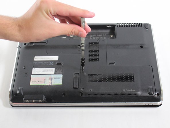

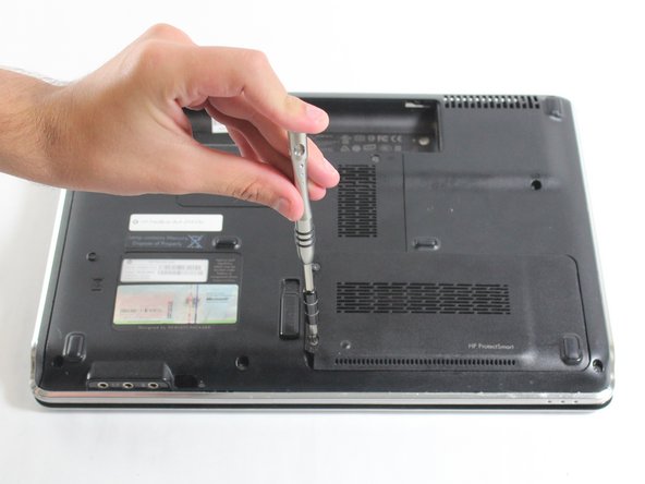

    • Locate the two 7.5 mm screws on the hard drive case plate.
    • Use the Phillips #0 screw driver to remove both 7.5 mm screws.
    • Be sure to place the screws somewhere they will not roll away so that you do not lose them.

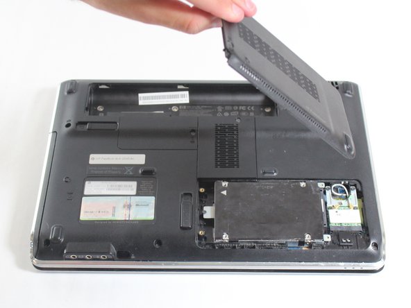

    • Remove the hard drive case plate.
    • You may want to use an opening pick under the leftmost edge to pry open the case plate if you have trouble opening the hard drive socket.

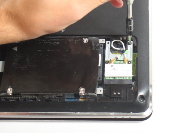

    • Unscrew and remove the two 2.5 mm black screws with a Phillips #0 screwdriver.
    • Put the screws somewhere they will not roll away so you do not lose them.
    • Notice that these 2.5 mm screws are black, while the other 2.5 mm screws in the laptop are gold.
    • There are two other screws on the wifi adapter/card; do not remove these. Only remove the two screws indicated in the picture.

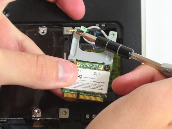

    • Locate the two antenna cable connectors. One is white and the other is black.
    • Pop off the two antenna cable connectors using your fingers or a plastic spudger.
    • Avoid using metal tools on delicate components, as they may cause further damage to the device.

    • Remove the wifi adapter/card from the socket.
    • When replacing the wifi adapter/card, make sure to reattach the white and black wires in the correct places. A sticker on the card has a black triangle and a white triangle, indicating where the wires reattach.
