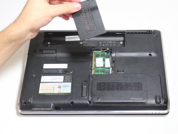

  5. HP Pavilion dv4-2045dx RAM Replacement, RAM: crwdns2935265:05crwdnd2935265:01crwdnd2935265:01crwdne2935265:0
    • Use the Phillips #0 screw driver to unscrew the 7.5 mm screw indicated in the photo.
    • The screw does not actually come out of the plastic cover; it only loosens and tightens.
  6. HP Pavilion dv4-2045dx RAM Replacement: crwdns2935265:06crwdnd2935265:01crwdnd2935265:02crwdne2935265:0 HP Pavilion dv4-2045dx RAM Replacement: crwdns2935265:06crwdnd2935265:02crwdnd2935265:02crwdne2935265:0
    • Lift the RAM case cover after the screw has been loosened.

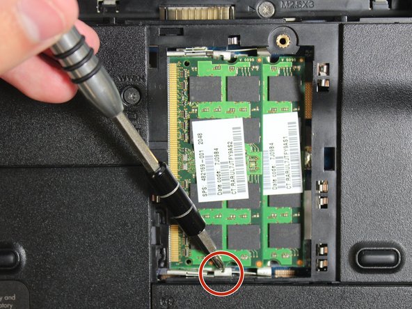

    • Locate the 2 silver release buttons inside the RAM socket, indicated in the pictures. They are on opposite sides of the socket.
  8. HP Pavilion dv4-2045dx RAM Replacement: crwdns2935265:08crwdnd2935265:01crwdnd2935265:01crwdne2935265:0
    • Simultaneously push the two silver release buttons away from each other towards the walls of the socket to release the RAM from the socket.
    • You may use your fingers or any plastic tool to push the release buttons.
    • The RAM card should pop out after you push the release buttons.
  9. HP Pavilion dv4-2045dx RAM Replacement: crwdns2935265:09crwdnd2935265:01crwdnd2935265:01crwdne2935265:0
    • Remove the RAM chip from the socket
    • The RAM has 2 long white tabs on its vertical side that fit into grooves in the RAM socket. This is what keeps the RAM chip in place.
