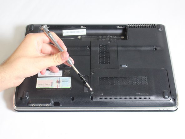

    • Locate two 7.5 mm screws on the hard drive case plate.
    • Use the Phillips #0 screw driver to loosen both 7.5 mm screws.
    • These screws do not come out of the case plate; they only loosen and tighten.
    • Be sure to place the screws somewhere they will not roll away so that you do not lose them.

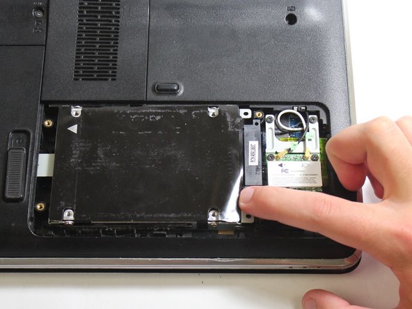

  8. HP Pavilion dv4-2045dx Hard Drive Replacement: crwdns2935265:08crwdnd2935265:01crwdnd2935265:02crwdne2935265:0 HP Pavilion dv4-2045dx Hard Drive Replacement: crwdns2935265:08crwdnd2935265:02crwdnd2935265:02crwdne2935265:0
    • Slide the hard drive horizontally to the left.
    • The hard drive may be difficult to push. If so, use a rigid tool to push the hard drive.
  9. HP Pavilion dv4-2045dx Hard Drive Replacement: crwdns2935265:09crwdnd2935265:01crwdnd2935265:02crwdne2935265:0 HP Pavilion dv4-2045dx Hard Drive Replacement: crwdns2935265:09crwdnd2935265:02crwdnd2935265:02crwdne2935265:0
    • Remove the hard drive from the socket
