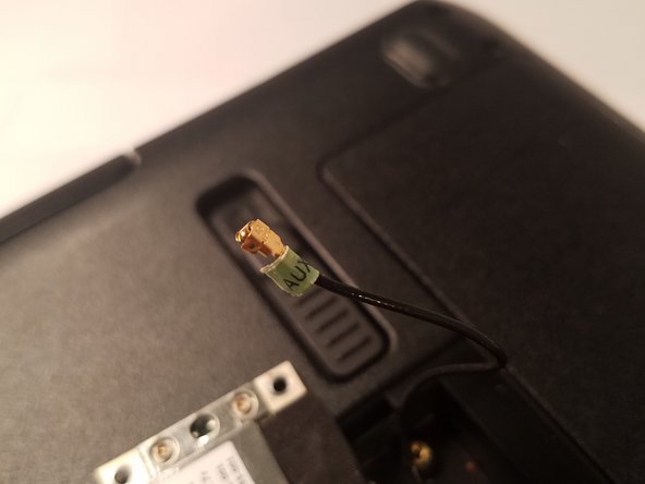

  4. HP Pavilion dv2913cl WiFi receiver Replacement: crwdns2935265:04crwdnd2935265:01crwdnd2935265:02crwdne2935265:0 HP Pavilion dv2913cl WiFi receiver Replacement: crwdns2935265:04crwdnd2935265:02crwdnd2935265:02crwdne2935265:0
    • Remove the two wires labelled AUX and MAIN from the chip.
    • Remember where these were attached previously as it is important for proper functionality after the replacement.
