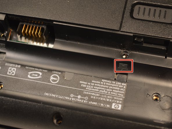

    • Locate the three screws for the keyboard by finding the small keyboard picture, remove these screws and flip the laptop back over.

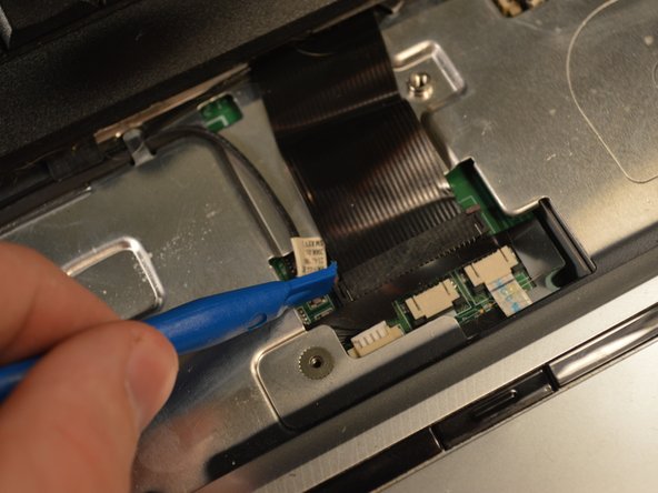

  5. HP Pavilion dv2913cl Keyboard Replacement: crwdns2935265:05crwdnd2935265:01crwdnd2935265:02crwdne2935265:0 HP Pavilion dv2913cl Keyboard Replacement: crwdns2935265:05crwdnd2935265:02crwdnd2935265:02crwdne2935265:0
    • Use the plastic opening tool to get underneath the plastic bar above the keyboard, pry upwards. Pry the keyboard upwards gently.
    • Be careful not to pull the keyboard too hard so you do not rip the silver ribbon cable attached to the laptop.

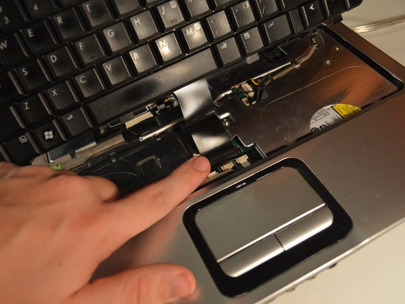

  6. HP Pavilion dv2913cl Keyboard Replacement: crwdns2935265:06crwdnd2935265:01crwdnd2935265:02crwdne2935265:0 HP Pavilion dv2913cl Keyboard Replacement: crwdns2935265:06crwdnd2935265:02crwdnd2935265:02crwdne2935265:0
    • Release the ribbon cable by using a flathead screw driver. Release the two tabs holding the cable and pull outwards.
    • Pull the keyboard up and out from the laptop.
