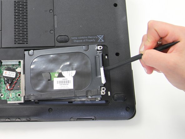

HP Pavilion dv2700 Hard Drive Replacement
  1. HP Pavilion dv2700 Hard Drive Replacement, Hard Drive: crwdns2935265:01crwdnd2935265:01crwdnd2935265:01crwdne2935265:0
    • To remove the battery, pull the tab to the left and lift the battery from the computer.
  2. HP Pavilion dv2700 Hard Drive Replacement: crwdns2935265:02crwdnd2935265:01crwdnd2935265:01crwdne2935265:0
    • Using a #0 Phillips Head screwdriver, unscrew the hard drive cover.
    • The screws cannot be removed from the cover.
    • To remove the cover, lift up and to the left.
  3. HP Pavilion dv2700 Hard Drive Replacement: crwdns2935265:03crwdnd2935265:01crwdnd2935265:01crwdne2935265:0
    • Using a #0 Phillips Head screwdriver, remove the screws holding the hard drive in place.
    • These are the two screws located on the right side of the hard drive.
  4. HP Pavilion dv2700 Hard Drive Replacement: crwdns2935265:04crwdnd2935265:01crwdnd2935265:02crwdne2935265:0 HP Pavilion dv2700 Hard Drive Replacement: crwdns2935265:04crwdnd2935265:02crwdnd2935265:02crwdne2935265:0
    • Lift the tab connected to the hard drive in order to remove it.
    • The hard drive may be difficult to remove by grabbing the tab. In this case, use the spudger to gently pry it from the computer.
