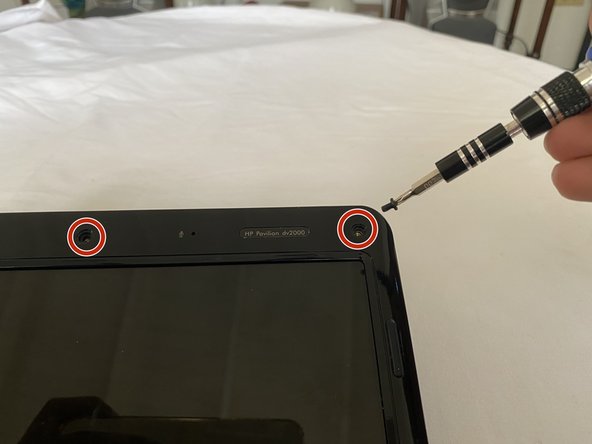

    • Use an opening tool to remove the four rubber screw covers located across the top of the bezel.
    • Remove the Phillips PM2.5×5.0 screws.
    • Remove the two rubber screw covers located at the bottom left and right of the bezel.

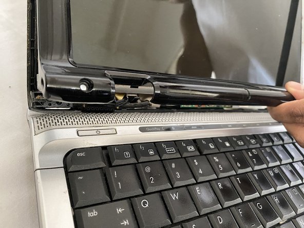

    • Flex the inside edges of the left and right sides and the top edge of the display bezel.
    • Lift the bezel with your finger until it disengages from the display enclosure.

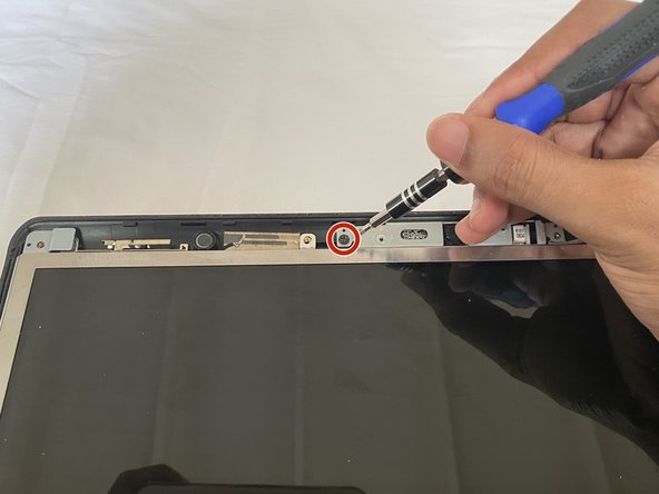

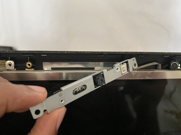

    • Remove the two Phillips PM2.5×4.0 screws that secure camera module.
    • Release the camera module assembly unit by simply pulling it out of the laptop.

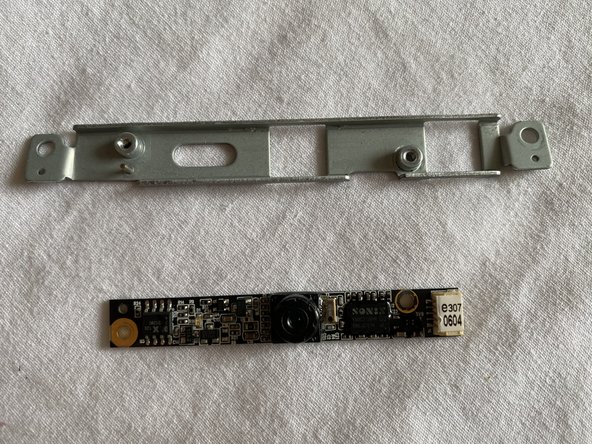

    • Disconnect the camera module cable from the camera module itself by pulling it out.
    • Be careful not to break the camera module cable.

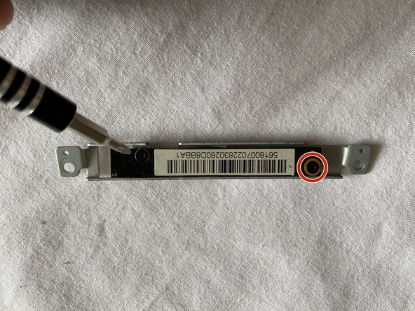

    • Turn the module upside down and remove the screws for the camera bracket.
    • Remove the camera module from the bracket.
