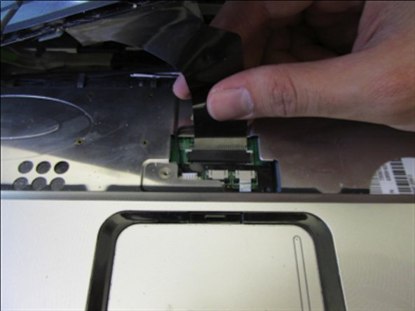

  3. HP Pavilion dv2000 Keyboard Replacement: crwdns2935265:03crwdnd2935265:01crwdnd2935265:02crwdne2935265:0 HP Pavilion dv2000 Keyboard Replacement: crwdns2935265:03crwdnd2935265:02crwdnd2935265:02crwdne2935265:0
    • The keyboard is held in by three small tabs near the bezel of the computer. Lifting the bezel frees the three tabs.
    • If you are removing the keyboard, the tabs will require a bit more upward force to pull away from the keyboard.
    • Remove the ribbon connecting the keyboard to the computer by pulling back on the ribbon (away from the track pad).
