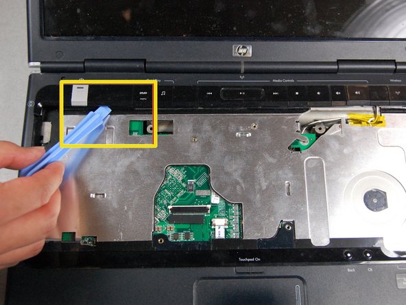

  7. HP Pavilion dv1000 Media Keys Replacement, Media Keys: crwdns2935265:07crwdnd2935265:01crwdnd2935265:01crwdne2935265:0
    • Turn the laptop upside-down again.
    • Remove the highlighted screws.
  8. HP Pavilion dv1000 Media Keys Replacement: crwdns2935265:08crwdnd2935265:01crwdnd2935265:02crwdne2935265:0 HP Pavilion dv1000 Media Keys Replacement: crwdns2935265:08crwdnd2935265:02crwdnd2935265:02crwdne2935265:0
    • Turn the laptop right-side up. Open the screen and tilt it all the way back.
    • Locate the media keys.
    • Gently lift up the media key strip using the plastic pry tool.
    • If there is too much resistance when prying, stop and search for cause of the resistance. Do not force the media keys.
