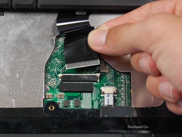

  6. HP Pavilion dv1000 Keyboard Replacement: crwdns2935265:06crwdnd2935265:01crwdnd2935265:02crwdne2935265:0 HP Pavilion dv1000 Keyboard Replacement: crwdns2935265:06crwdnd2935265:02crwdnd2935265:02crwdne2935265:0
    • Open the laptop.
    • Use the spudger to lift the keyboard.
    • Do not pull the keyboard up and away from the computer, because it is still attached by a ribbon cable.
    • Press the two white clips forward with your fingers and gently pull the ribbon from the clips.
