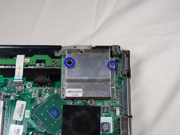

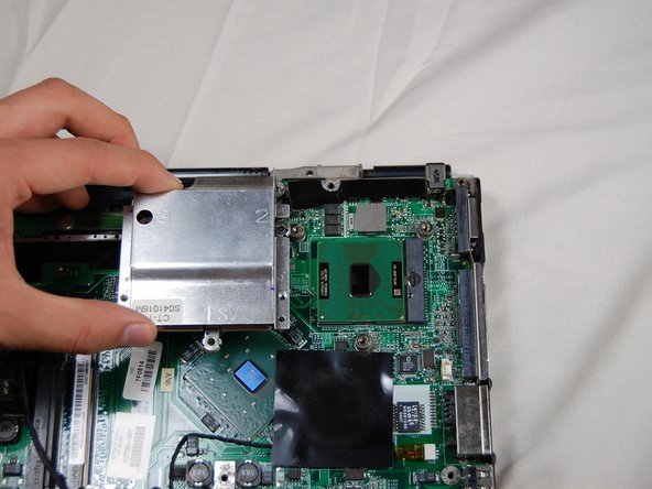

    • After removing the fan, locate the heat sink. The heat sink is the silver box above where the fan used to be.
    • Remove the two highlighted screws with a #00 Phillips screwdriver.
  27. HP Pavilion dv1000 Heat Sink Replacement: crwdns2935265:027crwdnd2935265:01crwdnd2935265:02crwdne2935265:0 HP Pavilion dv1000 Heat Sink Replacement: crwdns2935265:027crwdnd2935265:02crwdnd2935265:02crwdne2935265:0
    • After removing the screws gently lift the heat sink away from the computer.
