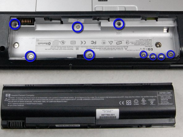

  17. HP Pavilion dv1000 Fan Replacement, Back Cover: crwdns2935265:017crwdnd2935265:01crwdnd2935265:02crwdne2935265:0 HP Pavilion dv1000 Fan Replacement, Back Cover: crwdns2935265:017crwdnd2935265:02crwdnd2935265:02crwdne2935265:0
    • Remove and set aside all of the highlighted screws in the first picture with a #00 Phillips screwdriver.
    • Remove and separately set aside all of the highlighted screws in the second picture with a #00 Phillips screwdriver.
    • Caution: There are two more screws to remove, so do not try and remove the back cover yet.

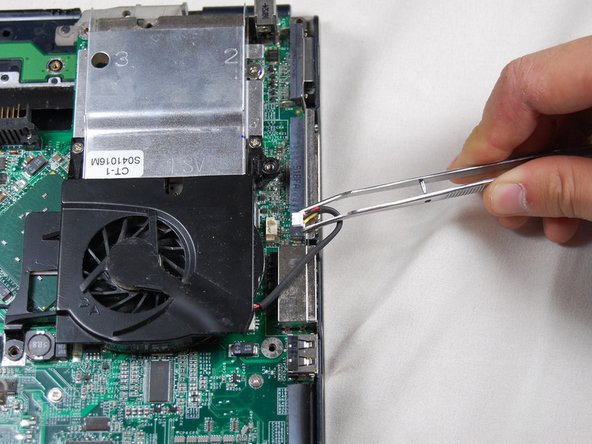

  24. HP Pavilion dv1000 Fan Replacement: crwdns2935265:024crwdnd2935265:01crwdnd2935265:02crwdne2935265:0 HP Pavilion dv1000 Fan Replacement: crwdns2935265:024crwdnd2935265:02crwdnd2935265:02crwdne2935265:0
    • After removing the screw, use your tweezers to remove the wire connecting the fan to the board. Do not pull the fan out immediately or it may damage the fan and/or the computer.
    • Squeeze the white plastic part of the wire connected to the computer and gently pull. This will detach the fan from the computer.

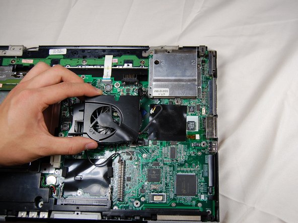

  25. HP Pavilion dv1000 Fan Replacement: crwdns2935265:025crwdnd2935265:01crwdnd2935265:02crwdne2935265:0 HP Pavilion dv1000 Fan Replacement: crwdns2935265:025crwdnd2935265:02crwdnd2935265:02crwdne2935265:0
    • With the wire removed, the fan should lift up easily from the board.
