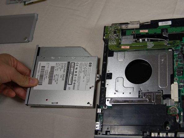

  22. HP Pavilion dv1000 CD Drive Replacement, CD Drive: crwdns2935265:022crwdnd2935265:01crwdnd2935265:01crwdne2935265:0
    • With the back cover removed, locate the CD drive.
  23. HP Pavilion dv1000 CD Drive Replacement: crwdns2935265:023crwdnd2935265:01crwdnd2935265:02crwdne2935265:0 HP Pavilion dv1000 CD Drive Replacement: crwdns2935265:023crwdnd2935265:02crwdnd2935265:02crwdne2935265:0
    • With a firm grip on the CD drive's outer casing, slide it away from the laptop.
