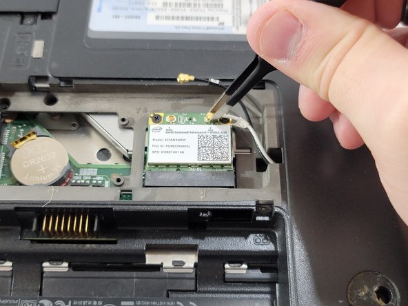

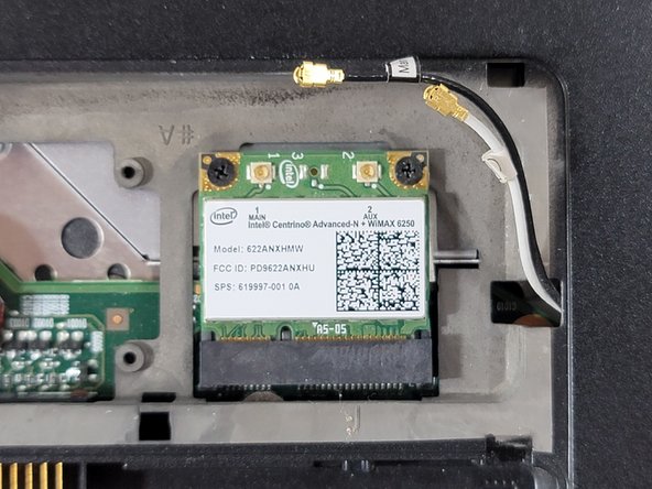

  5. HP Pavilion dm4-1265dx Wi-Fi Card Replacement, Wi-Fi Card: crwdns2935265:05crwdnd2935265:01crwdnd2935265:03crwdne2935265:0 HP Pavilion dm4-1265dx Wi-Fi Card Replacement, Wi-Fi Card: crwdns2935265:05crwdnd2935265:02crwdnd2935265:03crwdne2935265:0 HP Pavilion dm4-1265dx Wi-Fi Card Replacement, Wi-Fi Card: crwdns2935265:05crwdnd2935265:03crwdnd2935265:03crwdne2935265:0
    • Using ESD safe tweezers, gently disconnect the black and white wires connecting the Wi-Fi card to the device.
    • Move the wires out of the way to allow the Wi-Fi card to spring up without obstructions.

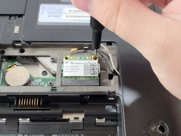

  6. HP Pavilion dm4-1265dx Wi-Fi Card Replacement: crwdns2935265:06crwdnd2935265:01crwdnd2935265:02crwdne2935265:0 HP Pavilion dm4-1265dx Wi-Fi Card Replacement: crwdns2935265:06crwdnd2935265:02crwdnd2935265:02crwdne2935265:0
    • Remove the two 3.0 mm screws from the Wi-Fi card using a Phillips #0 screwdriver.

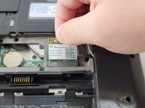

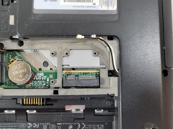

  7. HP Pavilion dm4-1265dx Wi-Fi Card Replacement: crwdns2935265:07crwdnd2935265:01crwdnd2935265:03crwdne2935265:0 HP Pavilion dm4-1265dx Wi-Fi Card Replacement: crwdns2935265:07crwdnd2935265:02crwdnd2935265:03crwdne2935265:0 HP Pavilion dm4-1265dx Wi-Fi Card Replacement: crwdns2935265:07crwdnd2935265:03crwdnd2935265:03crwdne2935265:0
    • The Wi-Fi card will spring upwards.
    • Gently remove the Wi-Fi card by pulling it away from its socket.
