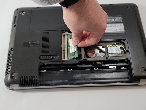

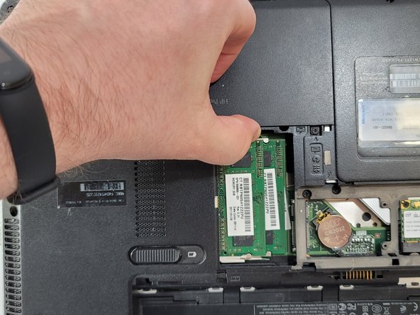

  5. HP Pavilion dm4-1265dx RAM Replacement, RAM: crwdns2935265:05crwdnd2935265:01crwdnd2935265:03crwdne2935265:0 HP Pavilion dm4-1265dx RAM Replacement, RAM: crwdns2935265:05crwdnd2935265:02crwdnd2935265:03crwdne2935265:0 HP Pavilion dm4-1265dx RAM Replacement, RAM: crwdns2935265:05crwdnd2935265:03crwdnd2935265:03crwdne2935265:0
    • Push the two clips on either side of the top RAM stick away from each other.
  6. HP Pavilion dm4-1265dx RAM Replacement: crwdns2935265:06crwdnd2935265:01crwdnd2935265:03crwdne2935265:0 HP Pavilion dm4-1265dx RAM Replacement: crwdns2935265:06crwdnd2935265:02crwdnd2935265:03crwdne2935265:0 HP Pavilion dm4-1265dx RAM Replacement: crwdns2935265:06crwdnd2935265:03crwdnd2935265:03crwdne2935265:0

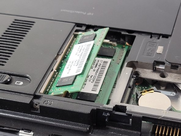

    • Pull the top RAM stick upwards.
    • The RAM stick should be at an angle to the device.
    • Gently pull the RAM stick away from the socket.

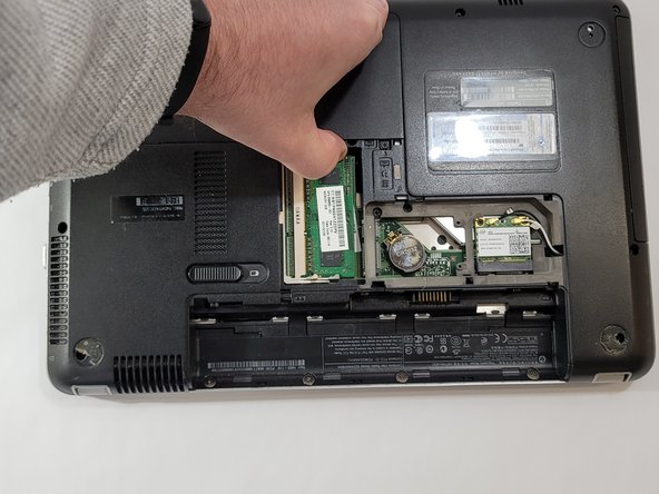

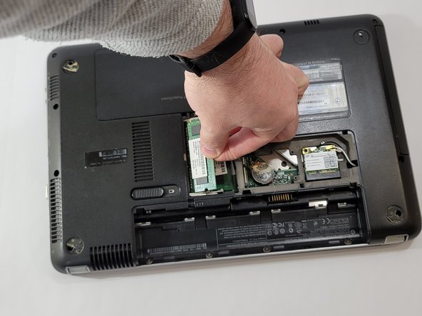

  7. HP Pavilion dm4-1265dx RAM Replacement: crwdns2935265:07crwdnd2935265:01crwdnd2935265:03crwdne2935265:0 HP Pavilion dm4-1265dx RAM Replacement: crwdns2935265:07crwdnd2935265:02crwdnd2935265:03crwdne2935265:0 HP Pavilion dm4-1265dx RAM Replacement: crwdns2935265:07crwdnd2935265:03crwdnd2935265:03crwdne2935265:0
    • Push the two clips on either side of the lower RAM stick away from each other.
  8. HP Pavilion dm4-1265dx RAM Replacement: crwdns2935265:08crwdnd2935265:01crwdnd2935265:03crwdne2935265:0 HP Pavilion dm4-1265dx RAM Replacement: crwdns2935265:08crwdnd2935265:02crwdnd2935265:03crwdne2935265:0 HP Pavilion dm4-1265dx RAM Replacement: crwdns2935265:08crwdnd2935265:03crwdnd2935265:03crwdne2935265:0
    • Pull the lower RAM stick upwards.
