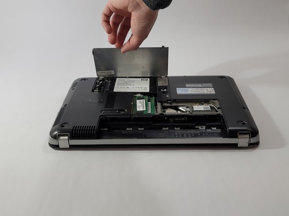

    • Pull back and lift the back panel to remove it from the device.
  5. HP Pavilion dm4-1265dx Hard Drive Replacement, Hard Drive: crwdns2935265:05crwdnd2935265:01crwdnd2935265:03crwdne2935265:0 HP Pavilion dm4-1265dx Hard Drive Replacement, Hard Drive: crwdns2935265:05crwdnd2935265:02crwdnd2935265:03crwdne2935265:0 HP Pavilion dm4-1265dx Hard Drive Replacement, Hard Drive: crwdns2935265:05crwdnd2935265:03crwdnd2935265:03crwdne2935265:0
    • Loosen the single captive screw holding the hard drive cover in place using a Phillips #0 screwdriver.
    • Lift the hard drive cover away and up to remove.

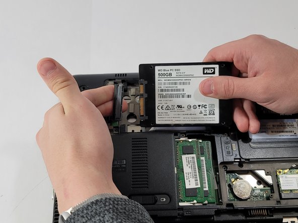

  6. HP Pavilion dm4-1265dx Hard Drive Replacement: crwdns2935265:06crwdnd2935265:01crwdnd2935265:03crwdne2935265:0 HP Pavilion dm4-1265dx Hard Drive Replacement: crwdns2935265:06crwdnd2935265:02crwdnd2935265:03crwdne2935265:0 HP Pavilion dm4-1265dx Hard Drive Replacement: crwdns2935265:06crwdnd2935265:03crwdnd2935265:03crwdne2935265:0
    • Lift the hard drive out of the device from the connector side.
    • Grasp the connector and pull it out of the hard drive.
    • Remove the hard drive from the laptop.
