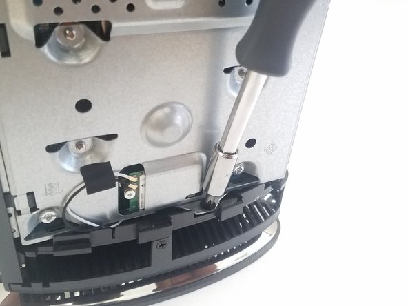

    • After removing your hard drive, remove the two 1.2mm Phillips #1 screws from the bottom of your case .

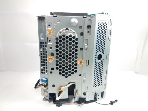

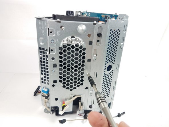

    • After removing the top cover, locate the system fan on the left side of memory compartment.
    • Remove three 1.2 cm Phillips #1 screws that connect the fan with the main body.

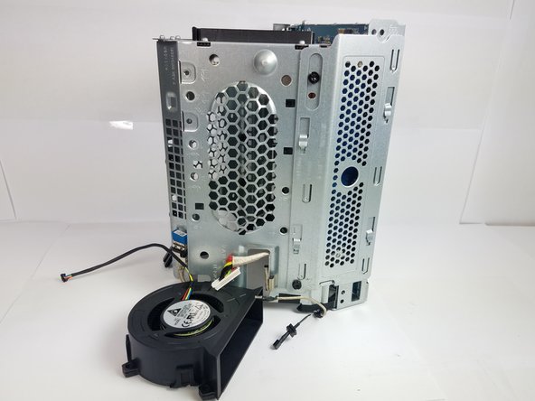

  13. HP Pavilion Wave 600-a014 System Fan Replacement: crwdns2935265:013crwdnd2935265:01crwdnd2935265:02crwdne2935265:0 HP Pavilion Wave 600-a014 System Fan Replacement: crwdns2935265:013crwdnd2935265:02crwdnd2935265:02crwdne2935265:0
    • Simply slide up the fan after removing the screws.
