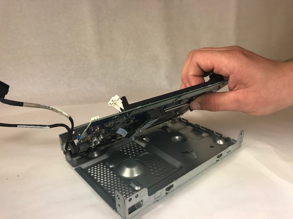

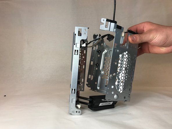

    • Remove two sides of the chassis from the motherboard and heatsink by removing one 24 mm screw using the Phillips Head #2 screwdriver and three 24 mm screws using the Torx Head #15 screwdriver and gently lifting away from the motherboard.
  20. HP Pavilion Wave 600-a010 RAM-Motherboard Replacement: crwdns2935265:021crwdnd2935265:01crwdnd2935265:02crwdne2935265:0 HP Pavilion Wave 600-a010 RAM-Motherboard Replacement: crwdns2935265:021crwdnd2935265:02crwdnd2935265:02crwdne2935265:0
    • Remove the heatsink from the motherboard by removing three 24 mm screws using the Torx Head #15 screwdriver and gently lifting away from the motherboard.
  21. HP Pavilion Wave 600-a010 RAM-Motherboard Replacement: crwdns2935265:022crwdnd2935265:01crwdnd2935265:02crwdne2935265:0 HP Pavilion Wave 600-a010 RAM-Motherboard Replacement: crwdns2935265:022crwdnd2935265:02crwdnd2935265:02crwdne2935265:0
    • Remove the motherboard from the chassis by removing four 24 mm screws (two on front and two on back) using the Torx Head #15 screwdriver and gently lifting out and away from metal chassis.
