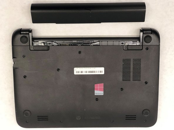

    • Power off device and place with battery facing up.
    • Ensure that your hands are not wet, even if the laptop is off or dead.
  2. HP Pavilion Touchsmart 10-e010nr Battery Replacement: crwdns2935265:02crwdnd2935265:01crwdnd2935265:02crwdne2935265:0 HP Pavilion Touchsmart 10-e010nr Battery Replacement: crwdns2935265:02crwdnd2935265:02crwdnd2935265:02crwdne2935265:0

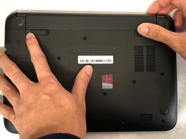

    • Push slider on left-hand side of device into unlocked position. This slider is not spring loaded so it should stay in position afterwards.
  3. HP Pavilion Touchsmart 10-e010nr Battery Replacement: crwdns2935265:03crwdnd2935265:01crwdnd2935265:02crwdne2935265:0 HP Pavilion Touchsmart 10-e010nr Battery Replacement: crwdns2935265:03crwdnd2935265:02crwdnd2935265:02crwdne2935265:0
    • Push in right-hand slider with your thumb and simultaneously apply slight pressure away from your body.
    • It may be helpful to keep your left thumb on the left slider and push with both thumbs.
  4. HP Pavilion Touchsmart 10-e010nr Battery Replacement: crwdns2935265:04crwdnd2935265:01crwdnd2935265:02crwdne2935265:0 HP Pavilion Touchsmart 10-e010nr Battery Replacement: crwdns2935265:04crwdnd2935265:02crwdnd2935265:02crwdne2935265:0
    • Battery should easily separate from main device.
