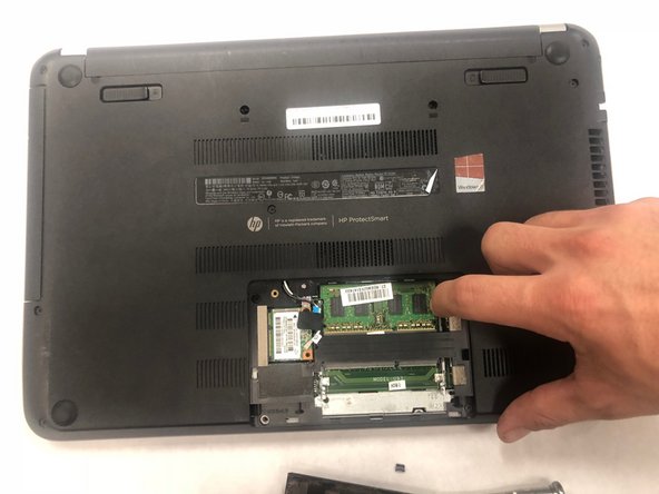

HP Pavilion TouchSmart 14z-n100 Ram Replacement
  1. HP Pavilion TouchSmart 14z-n100 Ram Replacement, Ram: crwdns2935265:01crwdnd2935265:01crwdnd2935265:02crwdne2935265:0 HP Pavilion TouchSmart 14z-n100 Ram Replacement, Ram: crwdns2935265:01crwdnd2935265:02crwdnd2935265:02crwdne2935265:0
    • Remove the two #1 Phillips 4mm screws that hold the cover in place.
  2. HP Pavilion TouchSmart 14z-n100 Ram Replacement: crwdns2935265:02crwdnd2935265:01crwdnd2935265:03crwdne2935265:0 HP Pavilion TouchSmart 14z-n100 Ram Replacement: crwdns2935265:02crwdnd2935265:02crwdnd2935265:03crwdne2935265:0 HP Pavilion TouchSmart 14z-n100 Ram Replacement: crwdns2935265:02crwdnd2935265:03crwdnd2935265:03crwdne2935265:0
    • Use the plastic opening tool to remove the cover. There are several clips that hold it on.
    • Carefully slide the plastic opening tool under the edge of the cover until it comes loose.
    • You can now remove the cover.
  3. HP Pavilion TouchSmart 14z-n100 Ram Replacement: crwdns2935265:03crwdnd2935265:01crwdnd2935265:03crwdne2935265:0 HP Pavilion TouchSmart 14z-n100 Ram Replacement: crwdns2935265:03crwdnd2935265:02crwdnd2935265:03crwdne2935265:0 HP Pavilion TouchSmart 14z-n100 Ram Replacement: crwdns2935265:03crwdnd2935265:03crwdnd2935265:03crwdne2935265:0
    • There are 4 clips total, one on each side of the RAM.
    • Remove the ram by pushing the clamps outward, away from the ram
    • After the pushing the clamps outward the ram should lift up and be able to slide out.
