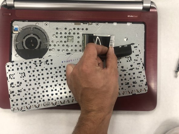

    • Gently pull the keyboard up with your fingers. Do not pull the keyboard too far from the computer.

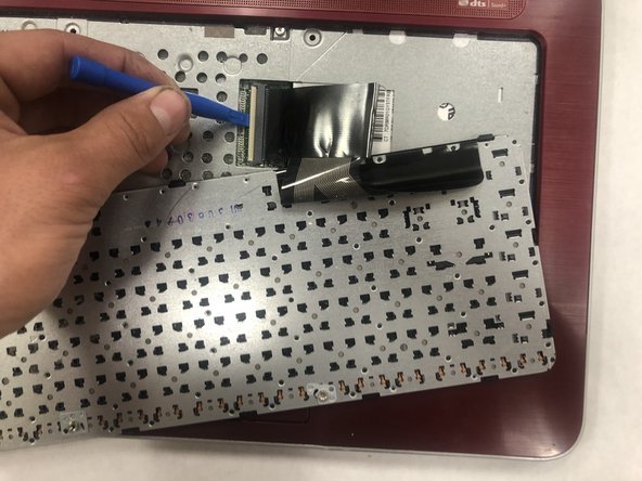

    • Lift the plastic retaining tab with a small plastic opening tool. The tab will rotate to the side but not remove from the laptop. After this gently pull the wire ribbon to remove it. The old keyboard is now completely removed.
