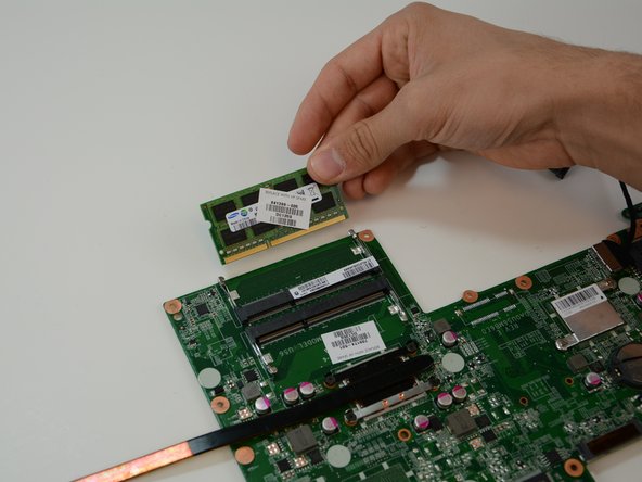

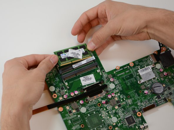

  6. HP Pavilion Sleekbook 15-b142dx RAM Replacement: crwdns2935265:06crwdnd2935265:01crwdnd2935265:03crwdne2935265:0 HP Pavilion Sleekbook 15-b142dx RAM Replacement: crwdns2935265:06crwdnd2935265:02crwdnd2935265:03crwdne2935265:0 HP Pavilion Sleekbook 15-b142dx RAM Replacement: crwdns2935265:06crwdnd2935265:03crwdnd2935265:03crwdne2935265:0
    • To gain access to the RAM flip the motherboard so that the bottom side is facing up. Then, locate the RAM card holder above the thick copper wire, right on the top edge.
    • To remove the RAM card use your fingers to pull the metal prongs on each side of the RAM card holder.
    • Then, grab the RAM card from the side edges and slide it outward.
