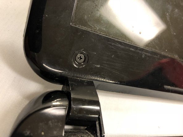

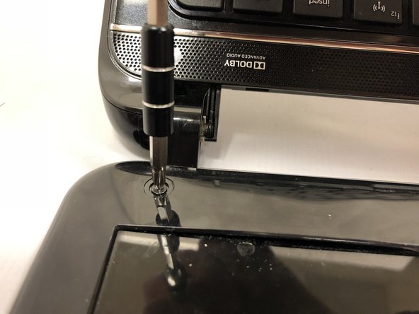

  4. HP Pavilion Sleekbook 14-b013cl Screen Replacement, Screen: crwdns2935265:04crwdnd2935265:01crwdnd2935265:03crwdne2935265:0 HP Pavilion Sleekbook 14-b013cl Screen Replacement, Screen: crwdns2935265:04crwdnd2935265:02crwdnd2935265:03crwdne2935265:0 HP Pavilion Sleekbook 14-b013cl Screen Replacement, Screen: crwdns2935265:04crwdnd2935265:03crwdnd2935265:03crwdne2935265:0
    • Using a 1.0 Flathead screwdriver, remove the two stickers covering the screws that hold the screen in place.
    • Use a Phillips #1 screwdriver to remove the two 3.2mm screws that are now visible.

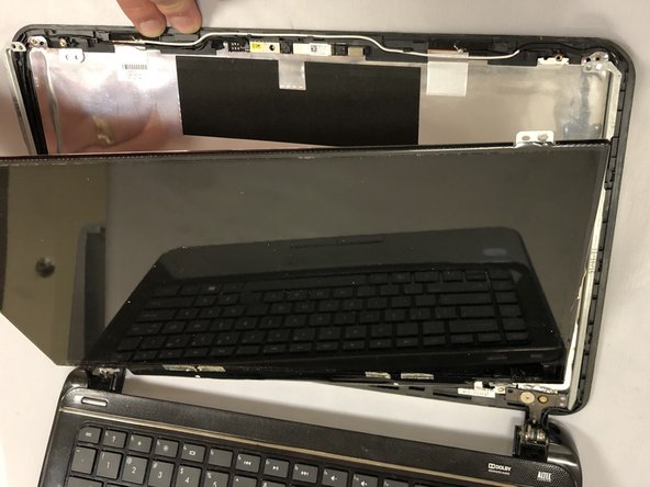

  6. HP Pavilion Sleekbook 14-b013cl Screen Replacement: crwdns2935265:06crwdnd2935265:01crwdnd2935265:02crwdne2935265:0 HP Pavilion Sleekbook 14-b013cl Screen Replacement: crwdns2935265:06crwdnd2935265:02crwdnd2935265:02crwdne2935265:0
    • Using a Phillips #1 screwdriver, remove the six 2.8mm screws holding the screen in place.
    • Lift the screen away from the cover until you have access to the connector cable near the bottom of the screen.
  7. HP Pavilion Sleekbook 14-b013cl Screen Replacement: crwdns2935265:07crwdnd2935265:01crwdnd2935265:02crwdne2935265:0 HP Pavilion Sleekbook 14-b013cl Screen Replacement: crwdns2935265:07crwdnd2935265:02crwdnd2935265:02crwdne2935265:0
    • Peel away any sticker holding the connector in place and simply pull the tab out of the connector parallel with the screen.
    • Remove the screen from the device.
