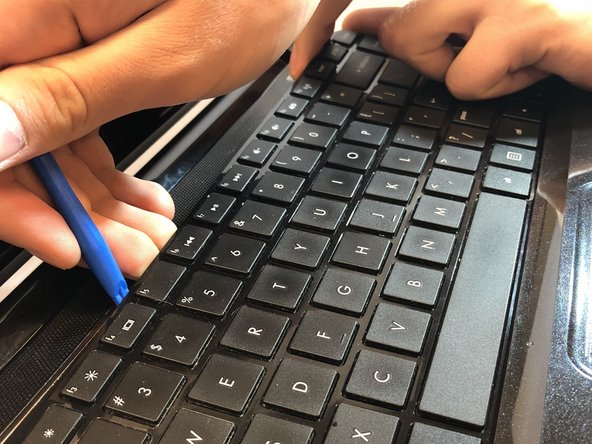

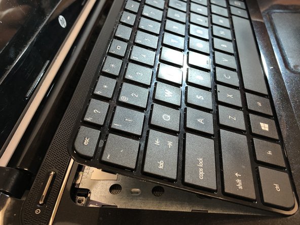

  5. HP Pavilion Sleekbook 14-b013cl Keyboard Replacement: crwdns2935265:05crwdnd2935265:01crwdnd2935265:03crwdne2935265:0 HP Pavilion Sleekbook 14-b013cl Keyboard Replacement: crwdns2935265:05crwdnd2935265:02crwdnd2935265:03crwdne2935265:0 HP Pavilion Sleekbook 14-b013cl Keyboard Replacement: crwdns2935265:05crwdnd2935265:03crwdnd2935265:03crwdne2935265:0
    • Use a plastic opening tool to pry up one of the upper counters on the keyboard
    • Run the tool along the upper edge of the keyboard and towards the opposite corner to release the latches.

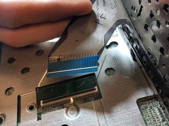

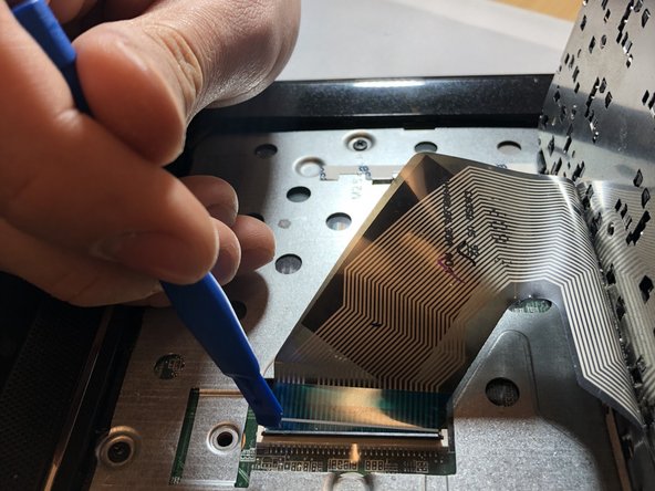

  6. HP Pavilion Sleekbook 14-b013cl Keyboard Replacement: crwdns2935265:06crwdnd2935265:01crwdnd2935265:03crwdne2935265:0 HP Pavilion Sleekbook 14-b013cl Keyboard Replacement: crwdns2935265:06crwdnd2935265:02crwdnd2935265:03crwdne2935265:0 HP Pavilion Sleekbook 14-b013cl Keyboard Replacement: crwdns2935265:06crwdnd2935265:03crwdnd2935265:03crwdne2935265:0
    • Push the button to release the connector and pull it out and remove the keyboard
