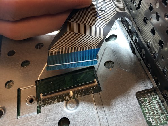

  6. HP Pavilion Sleekbook 14-b013cl Hard Drive Replacement: crwdns2935265:06crwdnd2935265:01crwdnd2935265:03crwdne2935265:0 HP Pavilion Sleekbook 14-b013cl Hard Drive Replacement: crwdns2935265:06crwdnd2935265:02crwdnd2935265:03crwdne2935265:0 HP Pavilion Sleekbook 14-b013cl Hard Drive Replacement: crwdns2935265:06crwdnd2935265:03crwdnd2935265:03crwdne2935265:0
    • To disconnect the wire, pry up on the latch holding it in its socket.

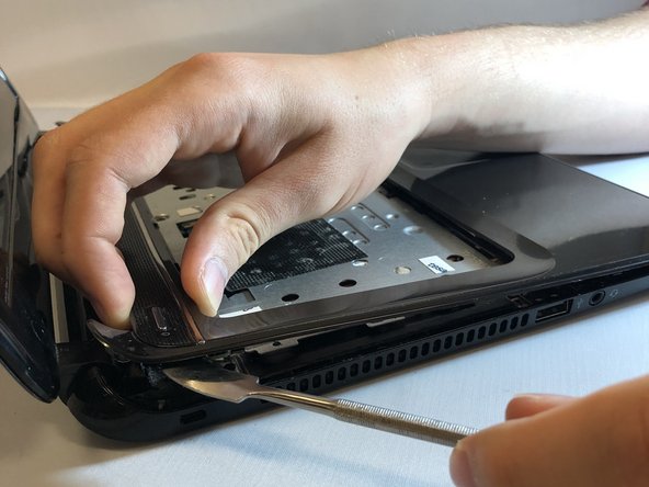

    • Flip the laptop back over.
    • Using a plastic or metal spudger, carefully pry the top and bottom halves of the case appart.
    • Don't push the metal spudger in too far or you might damage the laptops internal components.
    • Do not pull the halves apart yet as there are still wires attaching them together.

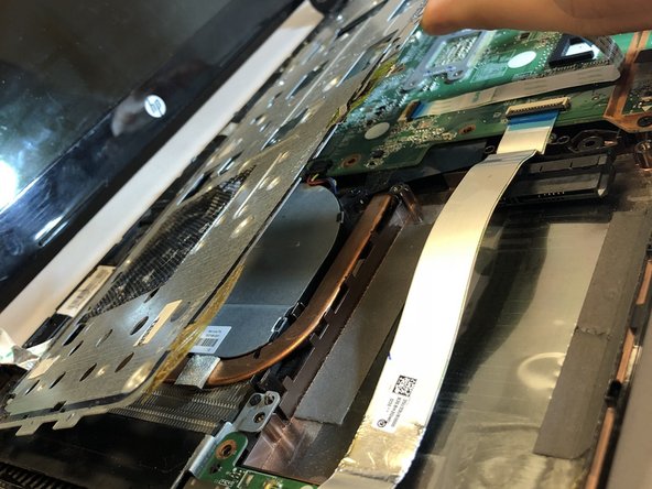

  8. HP Pavilion Sleekbook 14-b013cl Hard Drive Replacement: crwdns2935265:08crwdnd2935265:01crwdnd2935265:03crwdne2935265:0 HP Pavilion Sleekbook 14-b013cl Hard Drive Replacement: crwdns2935265:08crwdnd2935265:02crwdnd2935265:03crwdne2935265:0 HP Pavilion Sleekbook 14-b013cl Hard Drive Replacement: crwdns2935265:08crwdnd2935265:03crwdnd2935265:03crwdne2935265:0
    • Disconnect the touch pad wire by flipping the small black lever using a plastic opening tool.

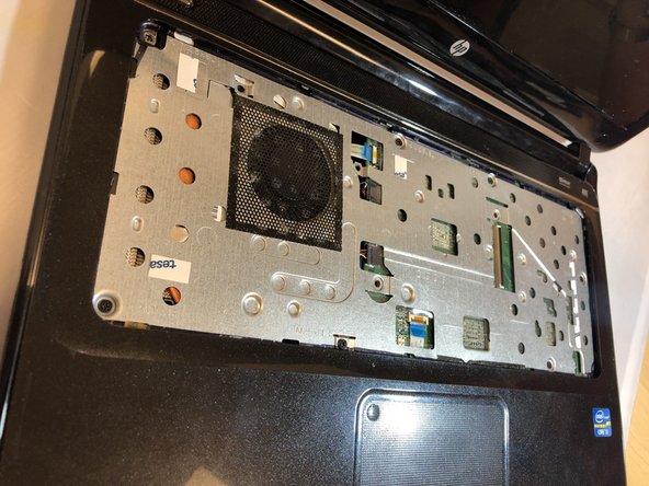

    • Pull the top half of the plastic case off of the laptop.
  11. HP Pavilion Sleekbook 14-b013cl Hard Drive Replacement: crwdns2935265:011crwdnd2935265:01crwdnd2935265:03crwdne2935265:0 HP Pavilion Sleekbook 14-b013cl Hard Drive Replacement: crwdns2935265:011crwdnd2935265:02crwdnd2935265:03crwdne2935265:0 HP Pavilion Sleekbook 14-b013cl Hard Drive Replacement: crwdns2935265:011crwdnd2935265:03crwdnd2935265:03crwdne2935265:0
    • Remove all seven of the screws using a Phillips #0 screwdriver and pull the plate off the motherboard.
    • There is double sided tape holding the plate down, as well as the screws. Sufficient force will be required to remove the plate.

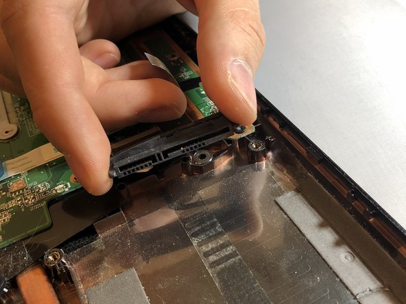

  13. HP Pavilion Sleekbook 14-b013cl Hard Drive Replacement: crwdns2935265:013crwdnd2935265:01crwdnd2935265:02crwdne2935265:0 HP Pavilion Sleekbook 14-b013cl Hard Drive Replacement: crwdns2935265:013crwdnd2935265:02crwdnd2935265:02crwdne2935265:0
    • Remove the four screws securing the hard drive to the motherboard.
    • Disconnect the hard drive cable by gently pulling it away from the hard drive.
