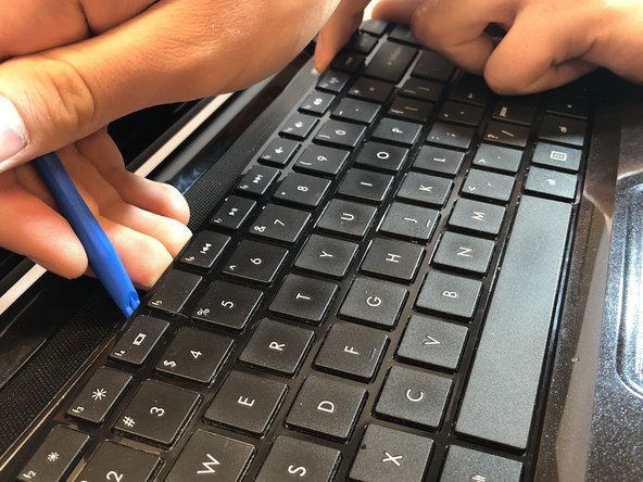

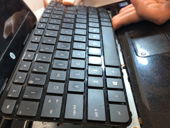

  5. HP Pavilion Sleekbook 14-b013cl Cooling Fan Replacement: crwdns2935265:05crwdnd2935265:01crwdnd2935265:03crwdne2935265:0 HP Pavilion Sleekbook 14-b013cl Cooling Fan Replacement: crwdns2935265:05crwdnd2935265:02crwdnd2935265:03crwdne2935265:0 HP Pavilion Sleekbook 14-b013cl Cooling Fan Replacement: crwdns2935265:05crwdnd2935265:03crwdnd2935265:03crwdne2935265:0
    • Using a plastic opening tool, pry up along the edge of the keyboard.
    • There is a wire connecting the keyboard to the motherboard. Do not completely pull the keyboard off until the wire is disconnected.

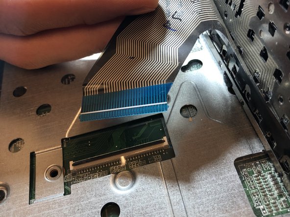

  6. HP Pavilion Sleekbook 14-b013cl Cooling Fan Replacement: crwdns2935265:06crwdnd2935265:01crwdnd2935265:03crwdne2935265:0 HP Pavilion Sleekbook 14-b013cl Cooling Fan Replacement: crwdns2935265:06crwdnd2935265:02crwdnd2935265:03crwdne2935265:0 HP Pavilion Sleekbook 14-b013cl Cooling Fan Replacement: crwdns2935265:06crwdnd2935265:03crwdnd2935265:03crwdne2935265:0
    • To disconnect the wire, pry up on the latch connecting it to the motherboard.

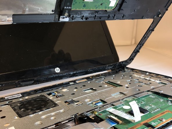

    • Using a plastic or metal spudger, carefully pry apart the palm rest from the rest of the laptop.
    • Be careful when using the metal spudger, as you could damage the internal components if the spudger is inserted too far.
    • Do not completely pull the halves apart yet because there are still wires holding them together.
  8. HP Pavilion Sleekbook 14-b013cl Cooling Fan Replacement: crwdns2935265:08crwdnd2935265:01crwdnd2935265:03crwdne2935265:0 HP Pavilion Sleekbook 14-b013cl Cooling Fan Replacement: crwdns2935265:08crwdnd2935265:02crwdnd2935265:03crwdne2935265:0 HP Pavilion Sleekbook 14-b013cl Cooling Fan Replacement: crwdns2935265:08crwdnd2935265:03crwdnd2935265:03crwdne2935265:0

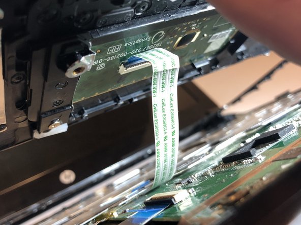

    • Disconnect the touch pad wire by flipping the black lever with a plastic spudger.

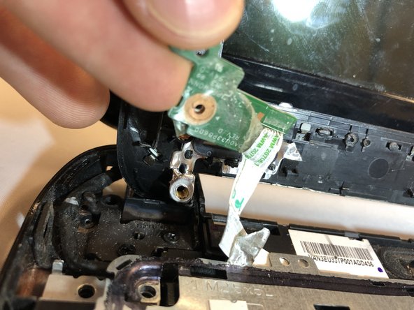

  9. HP Pavilion Sleekbook 14-b013cl Cooling Fan Replacement: crwdns2935265:09crwdnd2935265:01crwdnd2935265:02crwdne2935265:0 HP Pavilion Sleekbook 14-b013cl Cooling Fan Replacement: crwdns2935265:09crwdnd2935265:02crwdnd2935265:02crwdne2935265:0
    • Unscrew the circuit board underneath the power button.
    • Remove this circuit board by pulling up and away on the plastic tab.

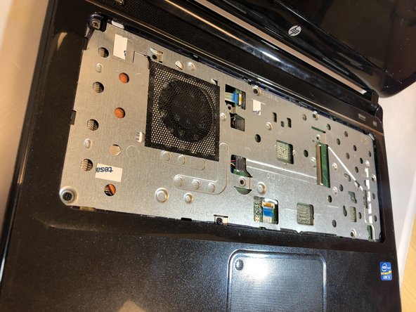

  10. HP Pavilion Sleekbook 14-b013cl Cooling Fan Replacement: crwdns2935265:010crwdnd2935265:01crwdnd2935265:03crwdne2935265:0 HP Pavilion Sleekbook 14-b013cl Cooling Fan Replacement: crwdns2935265:010crwdnd2935265:02crwdnd2935265:03crwdne2935265:0 HP Pavilion Sleekbook 14-b013cl Cooling Fan Replacement: crwdns2935265:010crwdnd2935265:03crwdnd2935265:03crwdne2935265:0
    • Using a Phillips #0 screwdriver, remove all the screws and take the metal plate off the mother board.
    • Double sided tape holds the plate down as well as the screws. You will need to apply force to remove the plate.
  11. HP Pavilion Sleekbook 14-b013cl Cooling Fan Replacement: crwdns2935265:011crwdnd2935265:01crwdnd2935265:02crwdne2935265:0 HP Pavilion Sleekbook 14-b013cl Cooling Fan Replacement: crwdns2935265:011crwdnd2935265:02crwdnd2935265:02crwdne2935265:0
    • Remove the three screws holding the cooling fan in place using a Phillips #0 screwdriver.
    • Using a plastic opening tool, remove the power cable for the fan.
    • Remove the fan from the device.
